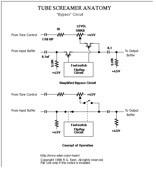

hi i would like to know i someone has a way or schematic to make a boos pedal truebypass, more specific, the boss Meg Distotion 2, and also the ibanez tube screamer ts808 reissue....
can it be done without modifying the buffers??

Matt
Quote from: copachino on May 24, 2014, 08:09:01 PM
I believe this article explains it all
http://www.geofex.com/article_folders/TStech/tsxfram.htm

Quote from: Matt on May 25, 2014, 10:38:39 AM
to get untainted sound when the effect is bypassed, guitarists like true bypass switching. One way to get this simply is to make a true bypass box external to the effect, and just use short cords to connect the original effect up to it. If you are dexterous and can mechanically get a DPDT stomp switch inside the TS box, you can convert it to true bypass. This conversion is simple in concept. The two switch JFETs are pulled off the circuit board. The one from the input buffer is ignored, the drain and souce holes for the one at the volume control are shorted with bit of wire. This disables the electronic switching and makes it permanently "on". Then the external DPDT switch is wired for true bypass around the whole mess
this its the flip flop circuit, but im not so sure where to shot the cables,

copachino
its a really pain in the ass, those flip flop, i will try out ans see if i dont have to trace and unsolder all the flip flop circuit... thanks fot you help
