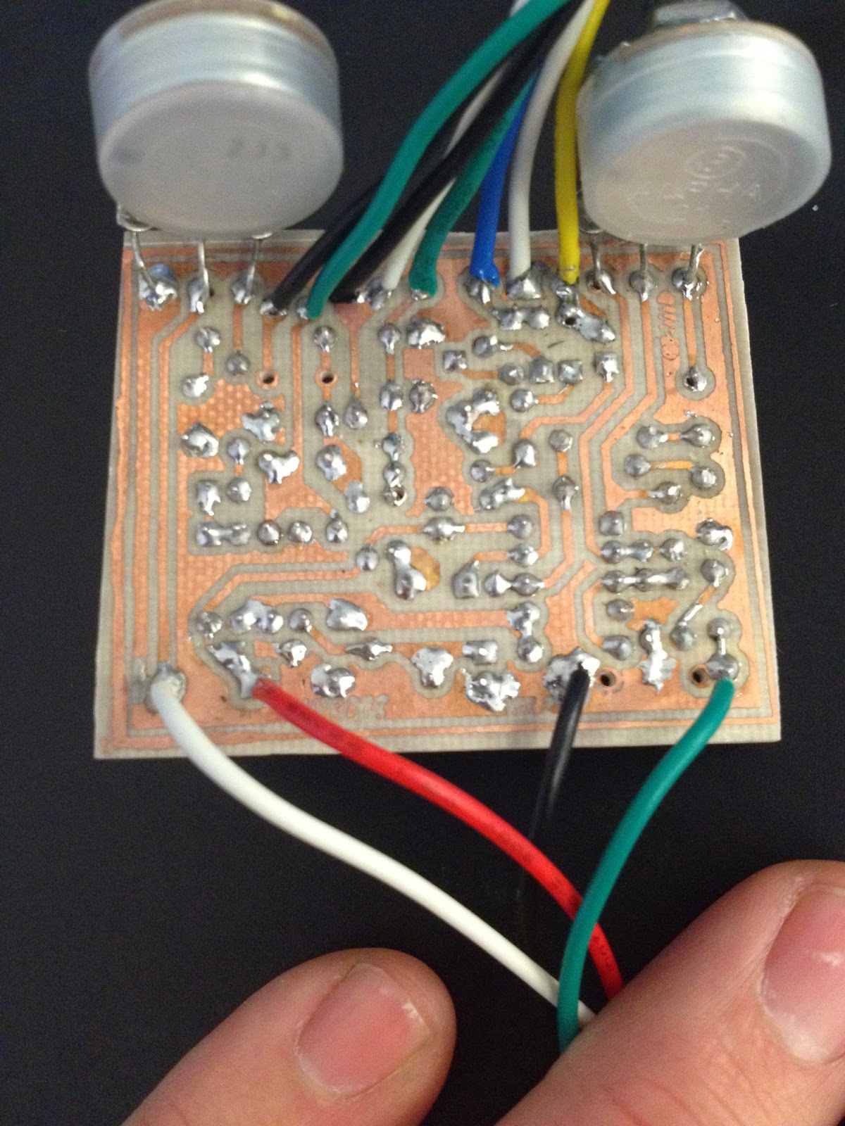

Pictures
Component side
Solder side
Help if you can. Thanks in advance!
Your voltages look correct. What about seeing if you have output on lug 1 of the pot. It kind of looks like your output wire might be soldiered to the ground pour, but I can not see for sure. I would definitely probe back wards on the schematic and see where the audio drops out.

I look something like a brigde not so sure but looks like that, looking at the pcb its a solder bridge, its about r6 and r14,
check that you may be grounding the signal over that brigde

And the winner is....Cody! The tiniest little solder bead was bridging the out put wire. Thanks again guys for the extra eyes!
