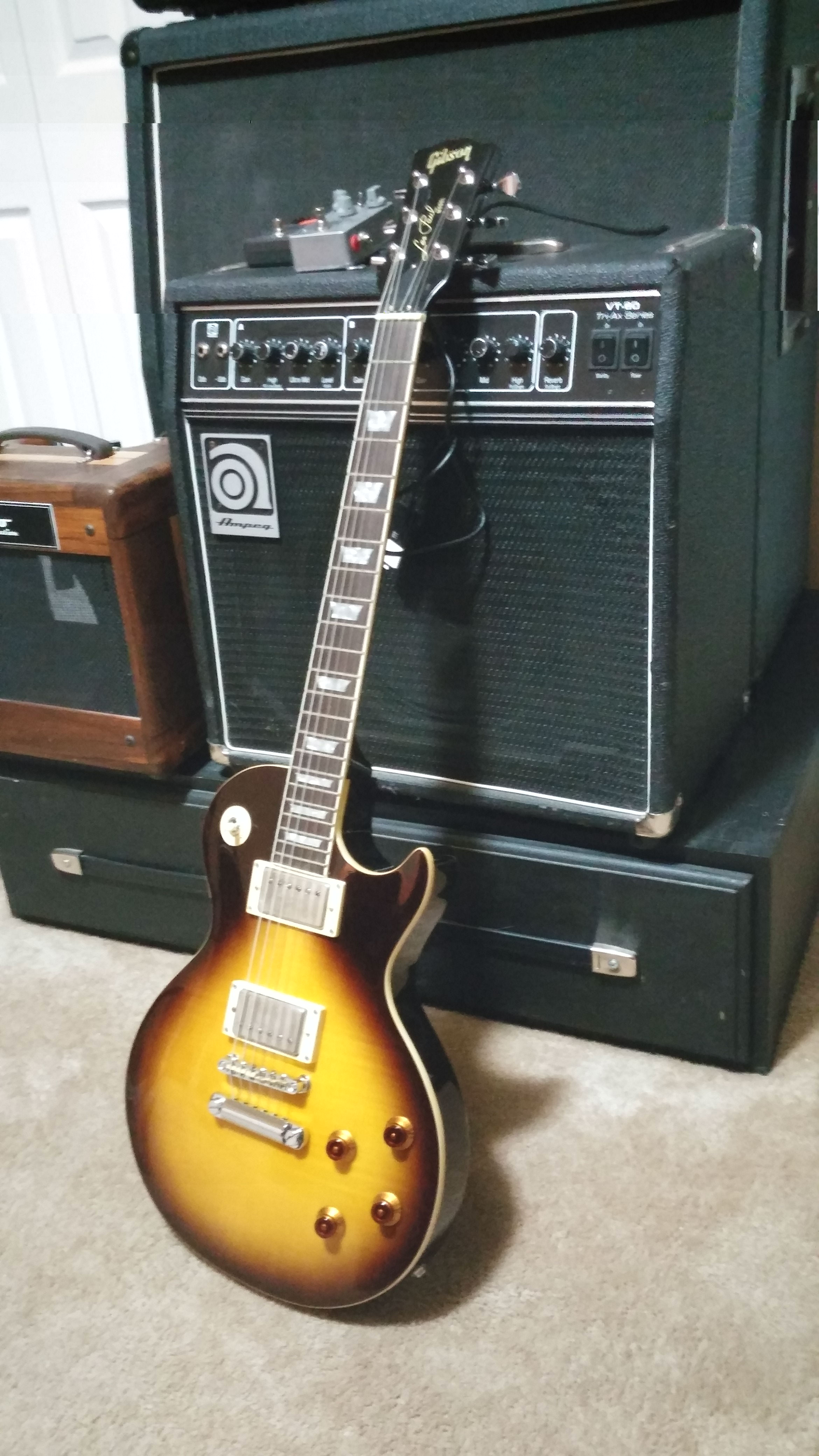

This is one of the GFS setneck bodies cut up for a Gibson peghead and then with some eBay decals.  Nobody is ever going to mistake this for a real LP but it's close enough that I obviously can't sell it.
XGP and Slick hardware.  Total investment is a bit south of $300.  Lots of work reshaping the peghead and getting the finish to match.  And look!  I've already buggered up the peghead corner.
Fat 59 neck profile, finish needed a fair bit of tweaking for overshoot and orange peel but nothing that can't be done by hand.  This is a killer little guitar and I'm really sold on the PAF-like Slick Old School pickups.

How is the fretwork?  I am always wary of the necks of budget guitars.  It seperates the men from the boys.

Yeah, the fretwork is a main concern for me. That and wondering if the neck is glued in straight and the holes are drilled in the right spots.
Fretwork was good. Touched up a few beyond the 14th fret and polished. The truss rod works well. Drilling was good but with CNC technology these days it's not too surprising. There was noticeable finish lift around many of the holes which leaves a minor air pocket. It's an easy fix: use thin super glue and touch the tip to the edge of the lift. Capillary action will suck glue in and the pocket will completely disappear. It's an easy and permanent fix and a pretty common thing if you pull the bridge on a budget guitar. I love this thing and am lusting after the tea burst quilt.
