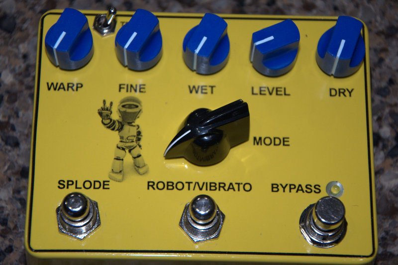

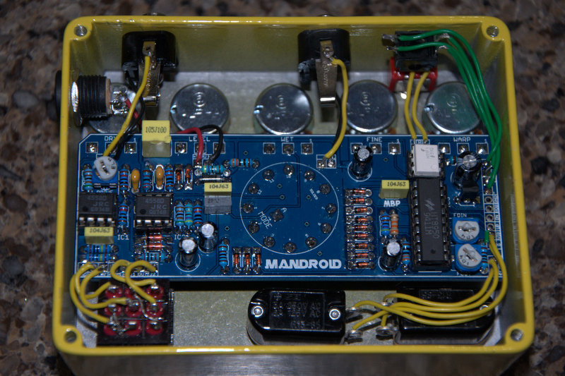

Here are the two newest VFE builds.  Super simple builds, great sounds coming out of them.

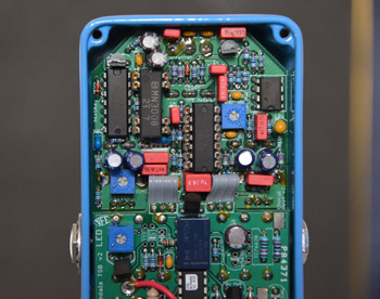

And this is something I've wanted to make for a while, a BBD Chorus in a 1590A enclosure.  This is a version of the zombie chorus, converted from PCB to perf.  It just fits :)  I had some issues with some ticking, but I added some shielded cable to the inputs and outputs and that took care of the issue.

Just a note, but I thought you were only meant to use 1 low ESR elec. cap on the switching board for the choral reef.
