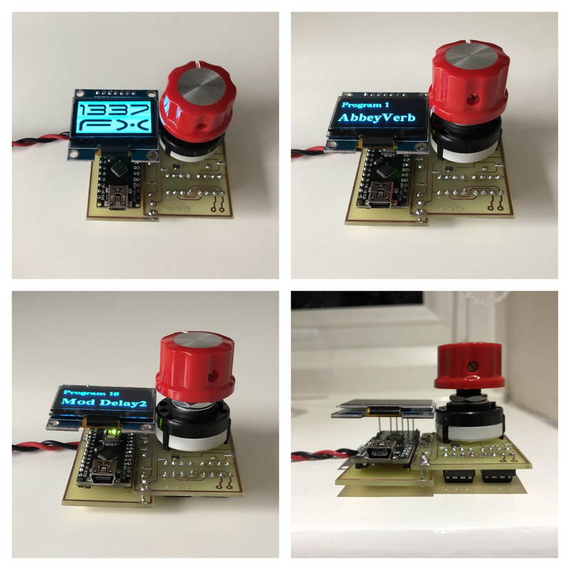

this connects to the fv-1 pins s0,s1,s2,sda,sck
it selects 16 algorithms from 2 eeproms
uses an Arduino nano
I updated the code to show the 3 control knob names for each algorithm:
https://www.dropbox.com/s/wey2foj2xwmgwxs/FV1%2016Position%20Switch%20Oled%20Display%20v2.zip?dl=0
Leetut
It uses the same algorithms as this, I just haven't put the oled in a pedal yet

I've had the parts to do something like this for nearly a year; but my friend who was going to help me with the arduino programing joined the Marines. Thanks for the info; maybe it will help me along in my project.

Very cool project, thanks for sharing!
