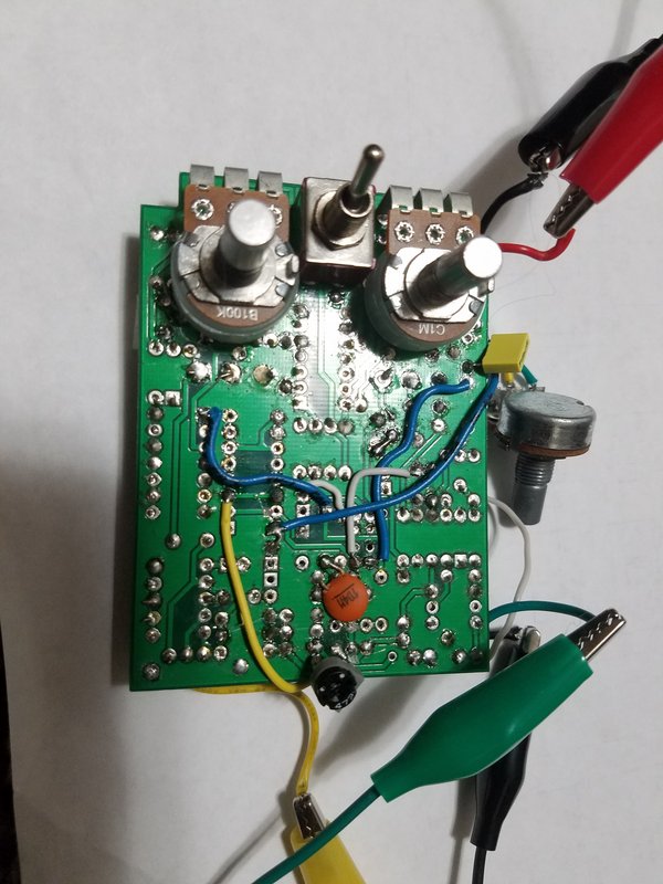

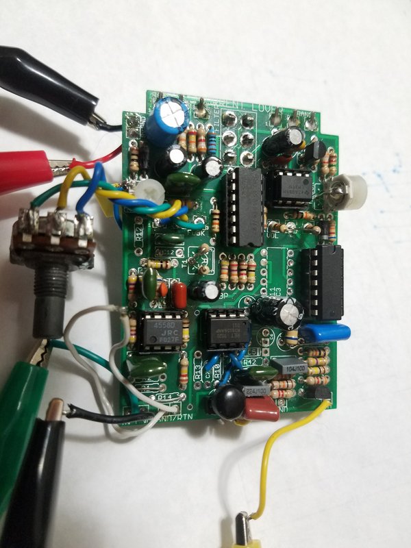

First off, I'm shocked I was able to get working RD5106's for a cheap price off Ebay (both of them I ordered worked, so that's a pretty good percentage!). Modifying a Current Lover pcb to accept an RD5106 is not the easiest thing...but it is worth it. All those sounds I recall from Gish and early Smashing Pumpkins recordings are here. There simply is no substitute for Reticon chips, IMHO. They have a special sound all their own, and the RD5106 has that same mojo as the SAD1024.
To be able to shoehorn this thing in, I used the schematic for the 1999 Deluxe Electric Mistress as a guide. The PCB looks a bit a mess (I've used it for lots of experimenting), but it works and sounds great. This is the Electric Mistress sound I always wanted:
I was surprised that EHX didn't add any kind of volume booster on the '99 Deluxe reissue. I tried sound directly off R15 and it had the usual volume drop. I think I could benefit from running this thing at 12v instead of 9v (as per the Deluxe Mistress reissue), so a charge pump may be in the future.

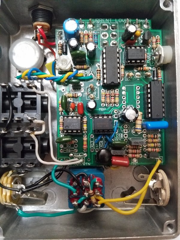

Here's the top enclosure shot, I rattle-canned it with a metallic charcoal and put the LED in a "pinhole":
The TZF input and output jacks:
And the guts now in the enclosure:
Now that I've had the chance to noodle around with it more, I can't believe the difference the RD5106 makes in this circuit. It's a different pedal. The Range is actually usable now throughout it's entire sweep. With a Panasonic BBD in there I noticed the Range never seemed right.  It has more of that 70's phased, washed & smeared sound, rather than the 80's metallic chorus sound of the MN3x07. I'll try to get some sound clips up soon.
