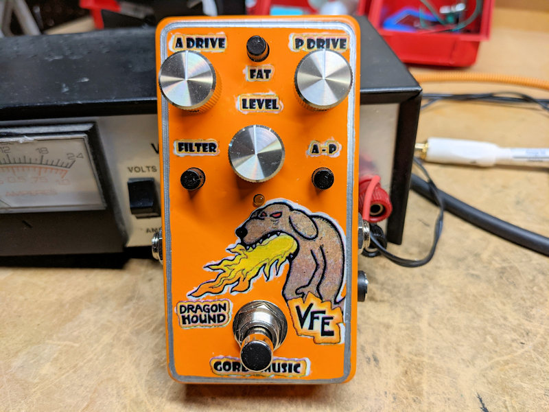

This is pretty slick and the two effects blend really nicely together.  Sort of a best of both without the shortcomings (at least from my perception) of either.  This one is hand painted white (under the decals) over an orange Tayda powdercoat and then waterslides.  Yes, it's an obvious ripoff of Peter's artwork tweaked to fit, but I really like the dog.  I also ran out of 100n MLCC's so used box films in a few spots.

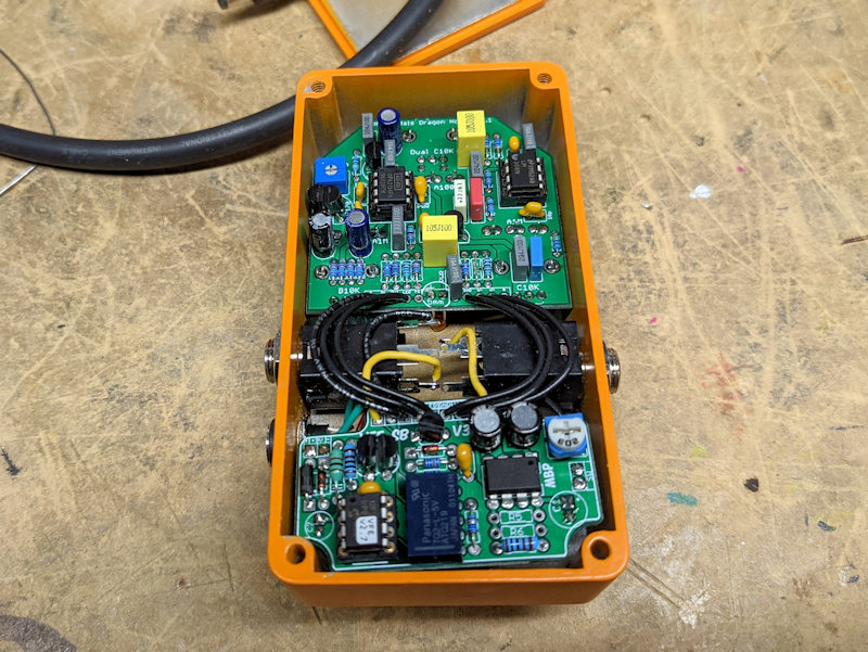

Nice! I recently ordered this board. Is that a 125b? Ialso where you find relays?

This one is a 1590b.  I've had the relay kicking around for a while but I think the last time I ordered some it was from Mouser.

Here is who stocks those TQ2-L-5V relays in the U.S. at the moment: https://octopart.com/tq2-l-5v-panasonic-697706
The Kemet EA2-5SNJ works for the VFE pedals as well and Mouser has them in stock, plus they are way cheaper too.
https://www.mouser.com/ProductDetail/551-EA2-5SNJ
Mouser has a listing of what will work in its place. If you go to the specs page, it's at the bottom.

How did you etch that silver groove around the tip of the enclosure - acid etch, roto-tool grinder, or laser?

I usually end up going with a 1590B for the VFEs.  I've had mixed luck getting a 125B with top mounts together.  It can be done, but I think those 1u caps near the front are going to be tricky.
Thanks folks.  I used a laser to give me a guide for painting and actually forgot to turn the border off.  I used a silver Sharpie marker to fill it in.  It's a tad clumsy but I think this whole concept is workable.  The downside is that it takes a lot of time and in the end I think a Tayda UV would look quite a bit better.
