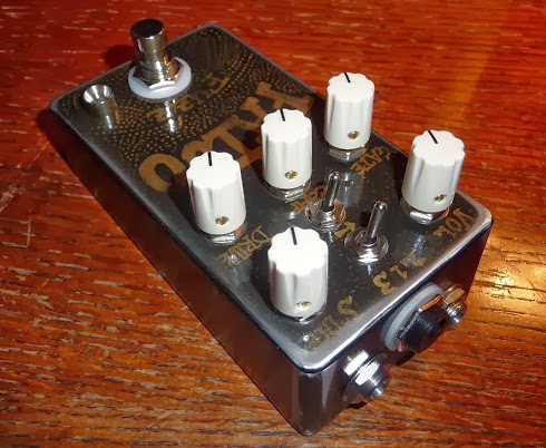

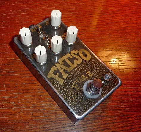

I had a request for a Fat Fuzz Factory clone and ended up using the cap arrangement from the Pudgii build doc on a GuitarPCB Industrial Fuzz PCB.  Usually I don't care for their PCB's, but this one was laid out by someone else (Bruce R. IIRC) and it was really nice to work with.  I unded up using 100nf, 330nf, and 2u2 on a DPDT On/Off/On switch with the 100n bridged across the middle lugs so you get 100n, 430n, and 2u3.  The guy I built it for didn't want the traditional Z.Vex layout so I put it in a wedged 125B.  It has a bypassable Klon Buffer on the output.  I usually find most fuzzes to be fun, but kind of one core tone per pedal, maybe some versatility by rolling back guitar volume, but this thing is incredible how different it can get depending on settings.  I have two etched PCB's selfdestroyer made for me from the Pudgii build doc and I am going to build a 2-in-1 for my board using them.

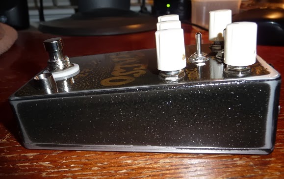

This indeed looks awesome.  I really like the angled enclosure.

Is that hand painted? If so, very well done!

Yeah, Sakura gold paint pen coated with a thin coat of clear, baked, sanded, and 2 more coats of clear.
That looks great Timbo. You are the paint pen master. The results always look great.
wolfingsworth
I love this build! The lettering looks amazing and I really like the layout.
