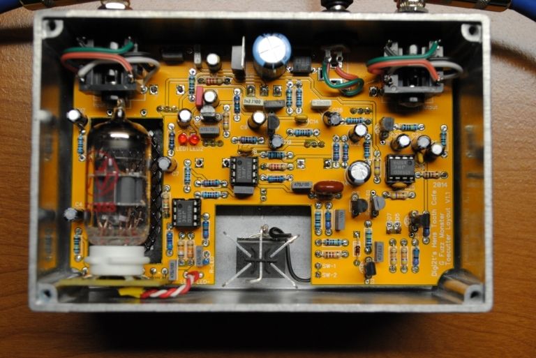

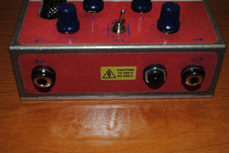

I finally finished (sort of) my Fuzz Monster using Digi2T's PCB (from DIYSB).  I say 'sort of' because it turns out that the only 12v AC adapter I have has a 2.5mm plug and my jack is 2.1mm.  I can fire it up, but any vibration causes the connection to go intermittent.  So I may be ordering some 2.5mm jacks and swapping this one out.
This build was a challenge to lay out in the enclosure.  It is designed with 9mm board mounted pots and board-mounted jacks (in/out & power).  I immediately decided against board mounting the power jack because I didn't want to deal with cutting a square hole in the side.  I already had to cut a square opening in the top and I figured that was enough stress.  Also, if anyone is capable of installing this board in the enclosure with board mounted in/out jacks, I bow down before you in reverence and awe.  That was a 3D puzzle I just was not able to solve.  I mounted them on the board but eventually gave up and popped them off.

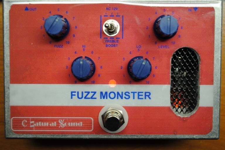

I made the tube port by using a step drill bit to drill a 3/4" hole at either end then cutting the sides with my Dremel using metal cutting wheels.  I clamped the enclosure to my bench with a metal straight edge lined up as a guide.  That turned out to be a little less difficult than I expected.
I highly recommend using the optional tube LED.  Otherwise it's not obvious why there's a gaping hole in the top of the enclosure.  ???
Also, the decal is actually straight across the top - that white bent line is the reflection of a fluorescent light in the Envirotex.

For the board mounted AC jack, you could always use those that sit flat with the edge of board and drill a tad oversized round hole so the AC plug fits in without touching the enclosure, like MXR and other brands does.
I love that you put a decal on the back as well! really gives it the pro look

I'm just beginning my own tube pedal build so this is really inspiring. Thank you for sharing. Btw.....the tube opening you cut out looks so professional.  Love it.

I only did a bench test for a few minutes so at this point my feedback is limited.  I have one other working fuzz - a Guitar PCP Industrial Fuzz - and that one is a wild beast.  The fuzz monster is more controlled, and it seemed to respond well to Hi / Low adjustments.  Note - don't copy my graphic on those knobs.  I noticed when testing that I labeled them backwards.   :-[
I just ordered a couple 2.5mm to 2.1mm adapters on eBay so I am going to keep both the panel mounted power jack and the AC adapter.  I should have them in a couple weeks so I can then do a real test.  I'll try to struggle through recording a demo.

I really like the labeling, it has a great retro look. The numbers around the knobs work very well. The tube slot turned out well and the grill suggests that there's something truly dangerous inside.
