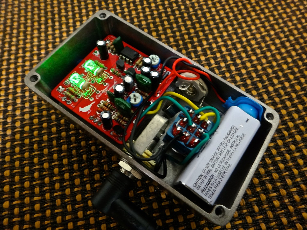

Here is a build of the older version of the Cardinal Tremolo. I've had the pcb sitting around for over a year, and I don't know why I didn't build this sooner, because it is a great effect!
I used 2N5458s for the JFets since J201s and 2N5457s are getting hard to come by these days. The 2N5458s work great once they're biased in, so it's a good alternative with very low noise (probably better than J201s).
I also used the generic KE-10720 LDRs from Tayda coupled with green LEDs in place of the VTL5C1 vactrols, and it worked out well, with a just a few changes to the resistor values in that part of the circuit.
It was actually a little tighter of a squeeze than I expected to get everything in there, but I really wanted to make sure this could run off a 9v battery. I had to dremel down a little bit of the lip on the bottom plate to get everything to fit.
This pedal can produce some really choppy to very subtle tremolo sounds. The circuit is an all-around outstanding design by Jon Patton.

I'm very surprised you were able to get the Tayda photocells to work; I've never been able to get anything but the VTL5C1 to work in either version for the full-range side. (The Tayda cells should work just fine in the treble side of the old version, but I didn't want to confuse people.)
I'm sure mine sounds a little different than what a VTL5C1 sounds like in there, but I really like it in this configuration. Maybe if I ever get some VTL5C1's, I'll try that and compare.
