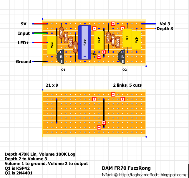

Thanks for all the awesome comments  8)  No BOM but it's only a few parts.  Here's the layout I used...
