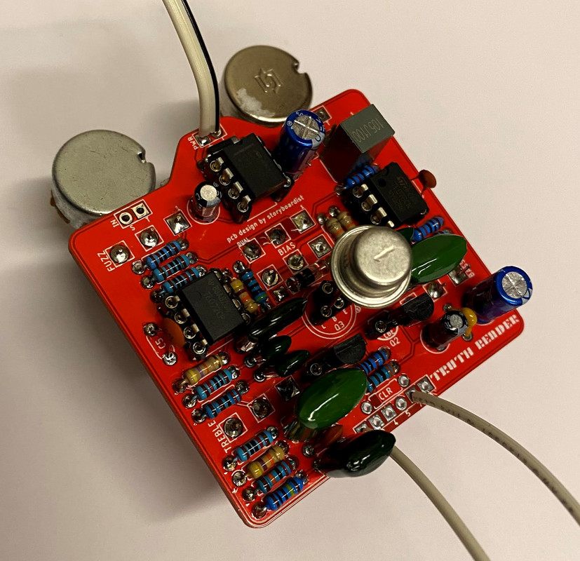

If you have a 100k dual gang it will work just fine. You just need to remove the 2, 180k resistors that are in parallel with them (going from the FSB trace schem). I suspect Keeley had a hard time sourcing 100k dual gangs in long leg form and just used some parallel resistance. Removed those two resistors in my build and it works just fine. You're right tho, it's a crazy fuzz box.
Thanks for the info! Unfortunately I only have a dual gang 10k right now. But I don't really think I'm going to mess with bias all that much. Gonna take your resistor removal and do this and see how I like it.

MTK
I connected the trimmers but before taking the 180K's out, I gave it a shot and it's awesome! Still has a pretty good range with the 100K's in place of the 250K. I found a sweet spot. I was able to reuse an old enclosure that used to have a Dirt Transmitter in it. It was a tight fit, 1590B. No fancy graphics right now, just the old label maker.
