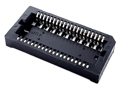

Has anyone come up with a way to socket an FV-1 on to a board that has SMD pads like the Headtrip?
The only socket type thing I see for SOIC chips are those expensive giant testers like from adafruit. nope.
https://www.adafruit.com/product/1281
However, I do see some SOJ sockets, but, those require the bent under type pins. Anybody tried something like this?
https://www.ebay.com/p/16012048571
You can see it a little better in this 40-pin version

They are, but I dont think the SOIC type pins will fit the holes like DIP pins. Also, maybe I missed it but Im not sure they make those in the 1.27mm pitch for SOIC
https://www.mill-max.com/products/new/smt-gull-wing-dip-sockets
