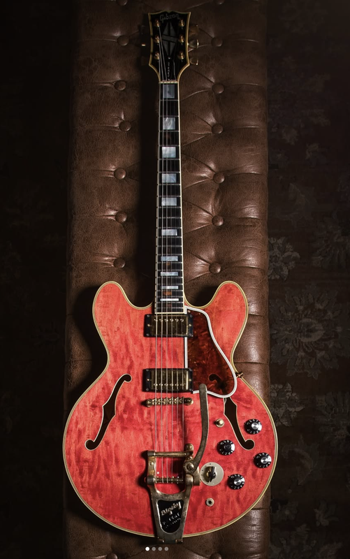

Guess it's not nice of me to post that teaser without a pic.  A quick backstory, I turn 50 in March and for my 50th I wanted to go guitar shopping in Nashville.  I've been watching the Instagram feeds of all the major dealers, waiting on "the one" to come up.  Lo and behold, this came up the Wednesday before Thanksgiving and I was smitten.  Looked at the description and it said a 1975 Gibson ES-355, making it a birth-year guitar, always wanted one.  Albeit a little early, my wife surprised me and bought it for me.  We went up the next weekend to try it out to be sure and needless to say, it's hanging on the wall now.  Below is the pic I saw on Insta, then a pic of me playing it at Carter's Vintage Guitar.

Beautiful. I love guitar shopping in Nashville.
What a great story and what an amazing looking guitar.  Enjoy that beast every day and Merry Christmas.
