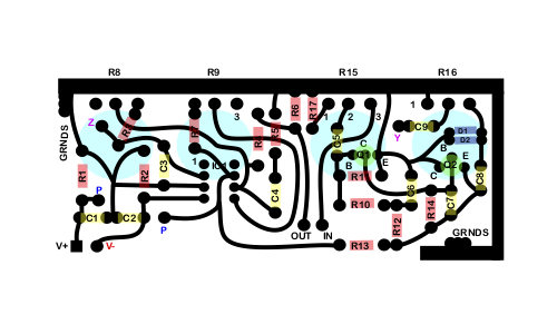

I got the itch had to scratch. drew this up—just took the two circuits you mentioned, lars, drew it up in Eagle and added the trimmer
haven't gotten it proto'd/verified

That looks great! Here was my proposed layout:
This was setup to use a CA3080 for the IC, since it sounded and behaved similar to the DM90 chip. At this point in the design I had ditched the ESR fuzz and ripped off the fuzz section of the MicroSynth. So basically this was a mashup of a Jordan Bosstone going into the MicroSynth.
Here are the parts I used:
R1 - 10k
R2 - 10k
R3 - 20k
R4 - 10k
R5 - 220R
R6 - 12k
R7 - 820R
R8 - B50K (Filter)
R9 - B10K (Bias)
R10 - 560k
R11 - 150k
R12 - 560k
R13 - 18k
R14 - 18k
R15 - B100k (Attack)
R16 - A100k (Volume)
C1 - .1uf ceramic (104)
C2 - .1uf ceramic (104)
C3 - .1uf ceramic (104)
C4 - .1uf ceramic (104)
C5 - .022uf Film   (223)
C6 - .022uf Film   (223)
C7 - 47pf ceramic
C8 - .022uf Film   (223)
C9 - 1uf tant or Film (105)*
Q1 - A417 NPN#
Q2 - 2N3638A PNP
IC1 - CA3080
*D1 - 1N4148
*D2 - 1N4148
# - This old transistor has an odd E,C,B configuration. You will have to bend your leads on a standard NPN transistor to conform to the layout. Hfe is in the 200 range.
* - Feel free to experiment with different diode types
The two pads marked "P" connected with a jumper.  The two pads marked "Y" & "Z" connected with a long jumper.

jessenator
Quote from: lars on May 20, 2023, 01:10:38 AM
Ahhh gotcha. So would you say the MicroSynth's circuit is more in-line (tone-wise) than the Bosstone? I'm assuming since your final design included it, but figured I'd ask anyway.

It would be interesting to see more of a stripped down Microsynth circuit with a Boss Tone added at the end. The rhythm sounds are categorically OpAmp Muff. It's the lead sounds that Microsynth and Boss Tone contribute so much to. The key pieces of the Microsynth are the octave effects and the fuzz it contains. Adding the boss tone on top is what sends it over the edge for those super compressed leads. Here's a recording of HKK I did a while back with just the OpAmp into a JCM800 with a G12T-75 recorded with a C414.
[soundcloud]https://soundcloud.com/user-534440441/test2-mp3?si=d080128de31242fbb1b8fcfecbf480f8&utm_source=clipboard&utm_medium=text&utm_campaign=social_sharing[/soundcloud]
Quote from: jessenator on May 20, 2023, 03:59:09 AM
I switched because the MicroSynth's circuit worked with the CA3080 I had. At that point, I thought I had fried my original DM90 I was using with the ESR graphic fuzz circuit (turned out, it was just a dead connection on my breadboard). Surprisingly, the ESR graphic fuzz circuit sounds very similar to a Microsynth when the DM90 chip is used. The current "Triclops Fuzz" pedal that I use on my board is just the old ESR circuit with the DM90. Here's some pics:

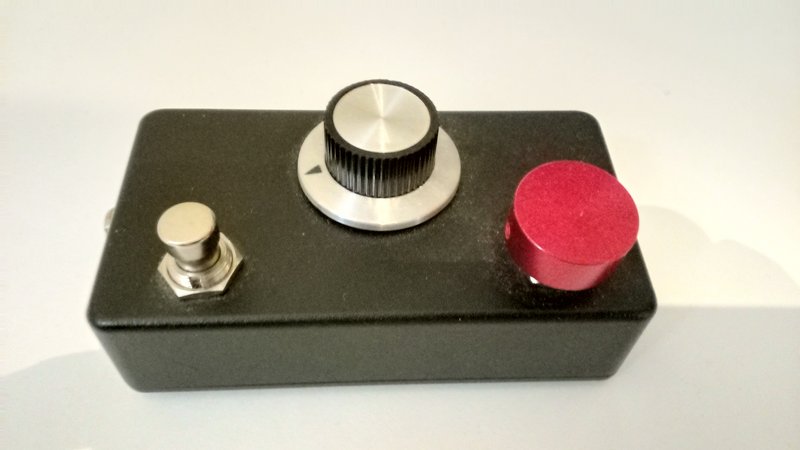

It's a pretty unruly fuzz with a ton of volume on tap. It works best as something you slam with an overdrive or distortion in front. The big red momentary switch is odd. I'm using it in place of what would normally be the filter control on the ESR. For some reason, it turns off the gated effect, so you can get some sustain out of higher notes. It will also freak out sometimes and make some weird buzzing noises when you release it. There's all kinds of weird voltage swings going on, but it's been working fine for years.
