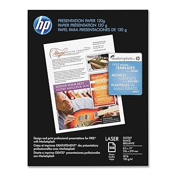

This is all I use:
Its got a guitar on the front.. so you know its made for instrument use. LOL
In all seriousness I have found it works the best for my situation.
I get it at Office Depot here in town but you can also get it from Amazon.
http://www.amazon.com/HP-Premium-Presentation-Glossy-8-5x11/dp/B003KU4DSW

Quote from: selfdestroyer on April 01, 2016, 04:09:10 AM
This is all I use:
I've been using that for my etches too. It seems to work really well. I just etched my first board but have been etching enclosures. I used my wife's t-shirt transfer machine(sublimation machine) for the board and it came out perfect. I wish I could use it for enclosures.
