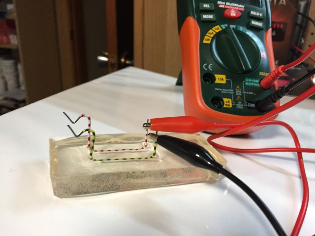

I made a little resistor tester out of some Envirotex and a couple paper clips.
That paper clip resistor cradle is brilliant!  Wished I'd thought of it.  I hate troubleshooting so I measure all my resistors as I populate the board.  It has reduced my box of fail ratio to near zilch.
