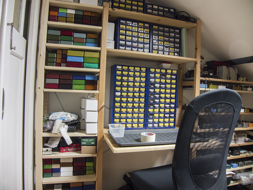

The new room is smaller and has a sloping ceiling, but actually, I now feel it's the better room because it has no weird corners and such like the other one. Behind those white panels at the far end, there's secret storage space.

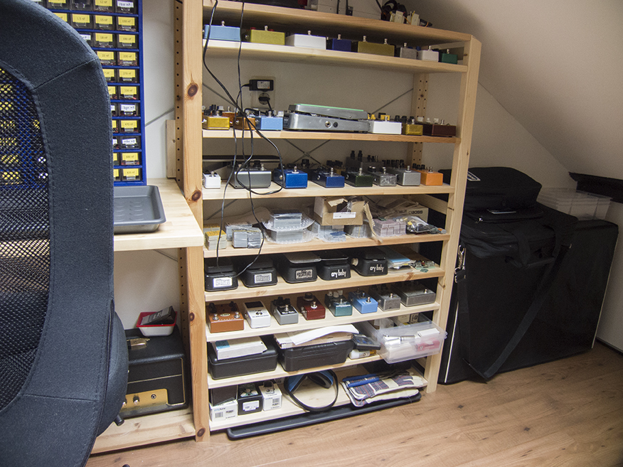

On the left, there's storage (boxes boxes, parts parts, pedals pedals) and a place to populate PCBs

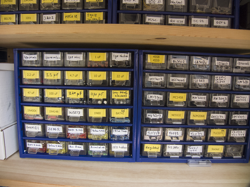

As I said: never been this organized before
Pedals and a DIY 18W combo amp hiding under the cover

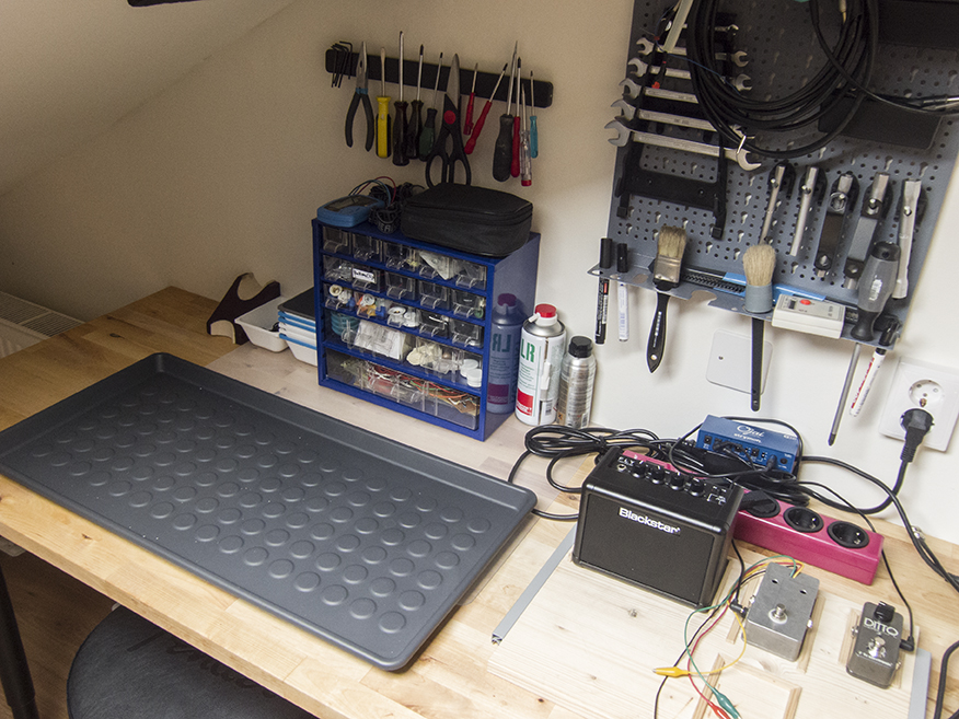

On the far end on the right is a space to assemble pedals or take them apart, with appropriate tools nearby and containers to stash the parts so they don't get lost while working on the pedal.
Also shown here is my little test setup: a looper with She Sells Sanctuary played into it, a sort of break out box with aligator clips to hook up circuits, and a small practice amp. Behind that is a power supply. Simple, but this makes repair jobs and testing so much easier.

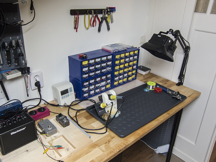

And finally, this is where the soldering should happen. I bought a second soldering iron. Instead of switching tips (and waiting for them to cool down) I now can just switch soldering irons when changing from leaded to lead free. I've switched to lead free for new projects permanently. It's actually working out pretty well. The parts bins contain switches and pots.

I can imagine what a visitor would say -- "Wow, this man is so rich, he has a whole drawer full of MN3005!

I have four in there...I would just put them in some assorted parts bin, but my girl friend won't have any of that. Everything in it's own place, she insisted.

Looks awesome! I have the same Ikea shelving units in my little work area. They're great. I also really like the tray, is it a baking pan? Look at all those enclosures you've got there, just waiting for guts...

Those are Ikea Baggmuck shoe trays I accidentally spotted while roaming their magazines looking for the stuff I actually needed ;)...

I've been using a Toolcraft defumer like you see in the last picture (it's not a lamp). I previously had a unit standing on the table top and I think this new one with the swinging arm is going to be a nice upgrade. IMO, it definitely helps. I haven't got asthma or anything, but I always noticed sore throat and coughing after soldering without any kind of active ventilation in the past. There's acidic stuff from the resin core in the fumes that can really affect your breathing. I used to use a bathroom fan with a hose attached transporting fumes out of the window years ago. Both options seem to work and keep things manageable. No sore throats or coughing since.
As far as lead goes: the consensus is that it's so heavy that it immediately falls down. There's no real risk of inhaling any vaporized lead particles. (strictly/technically speaking we should be talking about it's vapor pressure: there's no real chance of gaseous lead atoms escaping from the liquid when soldering). There have been quite extensive studies, measuring lead content in the blood of professional solderers. Virtually none was found I believe. Don't eat and drink at your work space and wash your hands afterwards and you should be fine. Wisdom handed down from RG Keen years ago (credit where credit is due).

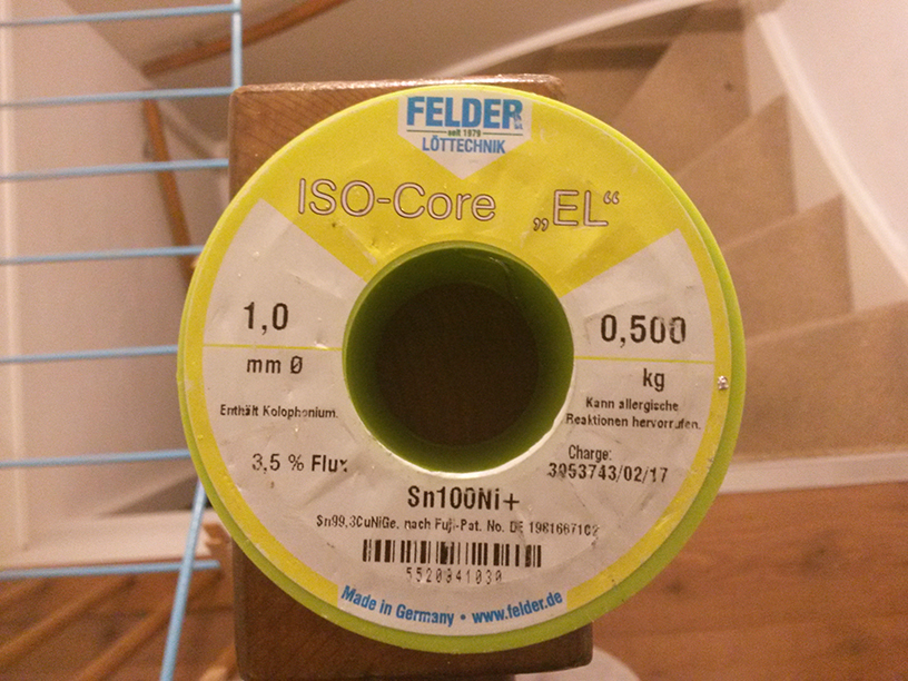

Here's a picture of the lead free stuff I've been testing out.
With leaded solders I used to solder at 330 degrees (Celsius). This stuff works nicely with the iron set to 360, maybe a little higher for big surfaces like pots. Flows well, nice and shiny joints just like with the good old stuff. Highly recommended.
On my list still is a heated desolderingpump or maybe a dedicated desoldering station, instead of just the pump and the wire. That should make life a lot easier as well.
