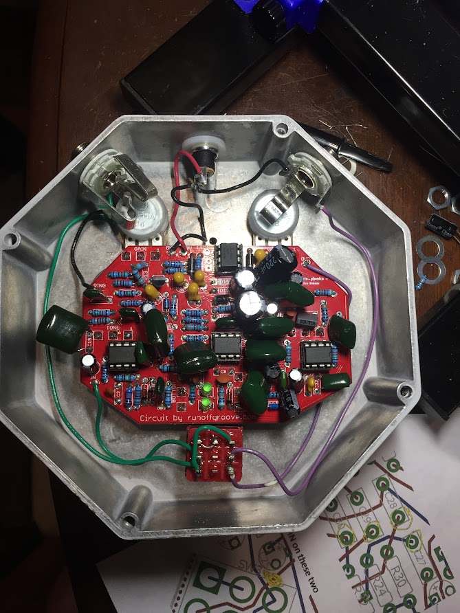

I made some PCBs for the ROG Thunderbird, being legit and following Brian Tremblay's licensing agreement (think i might sell a few).  I tried to follow good layout technique, but to be honest, all i know is to try to keep the power separate from the signal, then after a while of routing, that is out the door (I think i ran the Vcc right under one of the voltage diodes).
First build sounded amazing, but had a high pitch noise, and the white noise was too much.  Tried shielding and that did not work, finally figured out I have bad batch of LT1054's (ebay) (5 KHz switching freq) and once i found a good charge pump, it was much more quiet.    I'm going to avoid charge pumps for a while, struggling with bad ones in a few other builds (although TC1044SPCA's at mouser are like $1 right now).

ah crap!   stupid google photos.  I hope it's working now.  I'm signed out of google and can see them.

Is the wiring complete? There's a jumper to that middle row, assuming you just haven't wired up the LED?

Haha, i should try!   Yeah, I had not put in the led yet.

Juansolo did something cool with a noisegate on a thunderbird build.  The thunderbird is notoriously noisy.
