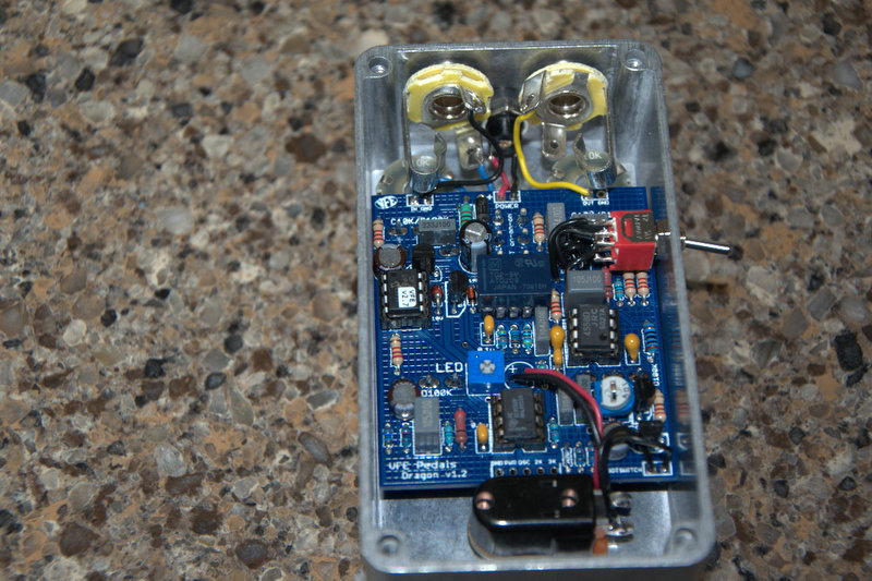

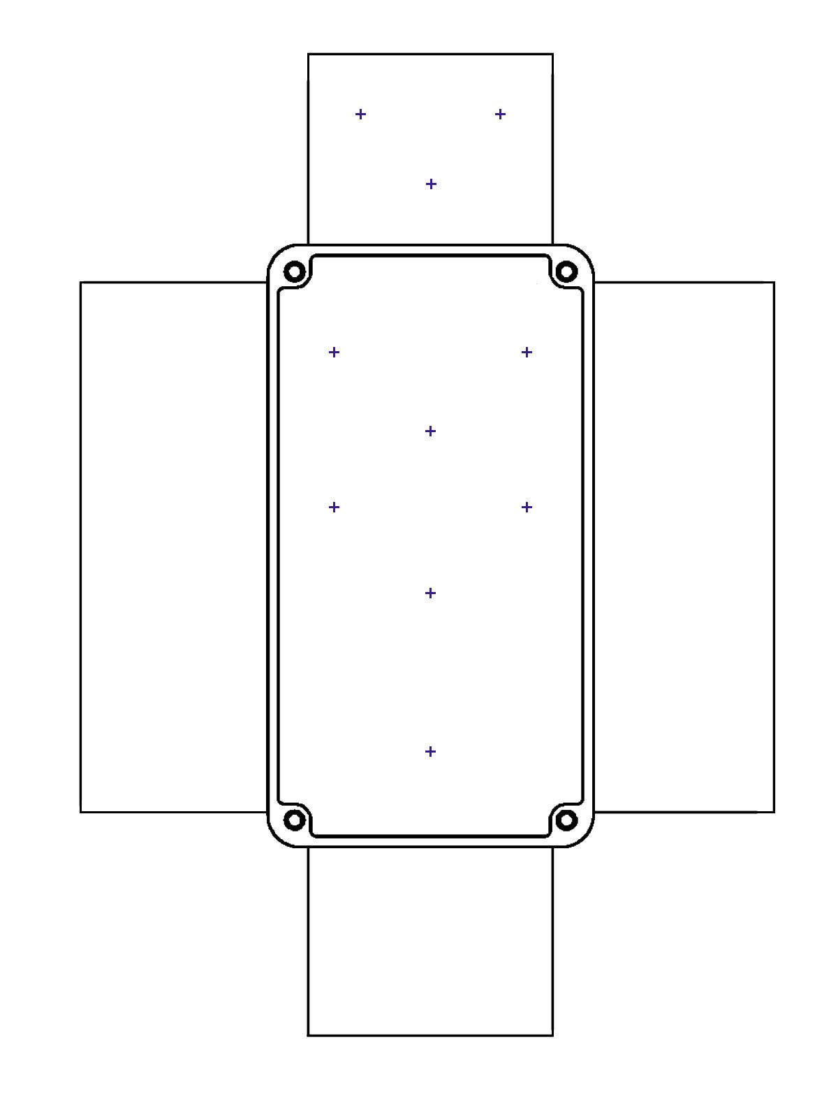

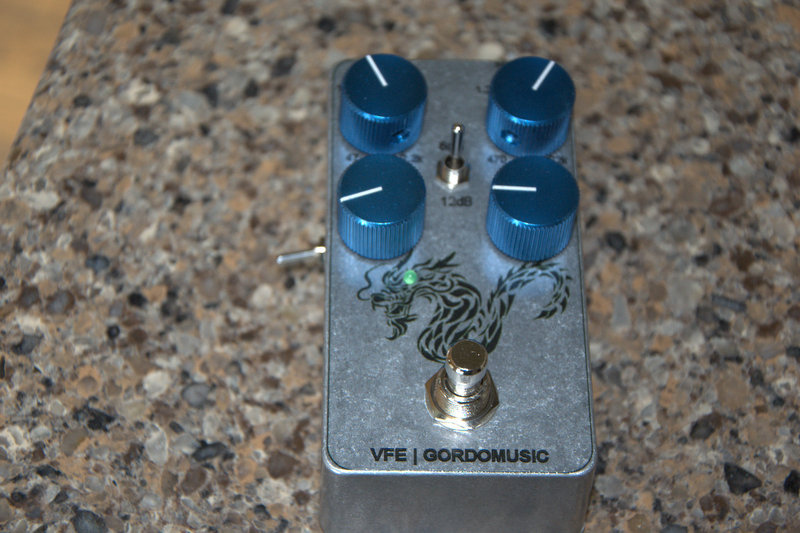

The usual disclaimer...double check this before you hack up an enclosure. I've tacked some Dragon photos along with it to show the results. The two weird things about this build are that I used an external buff/non-buffer switch (not really necessary but couldn't find a slide switch to fit the board), and I socketed the relay in an attempt to get the right one. The relay is different from the MadBean VFE's and I had NO intention of trying to desolder another one...
http://www.gordomusic.com/Madbean/Live Series drills.jpg
http://www.gordomusic.com/Madbean/Live Series drills.psd
http://www.gordomusic.com/Madbean/Live Series drills.pspimage
http://www.gordomusic.com/Madbean/Live Series VFE 1590B2.pdf
