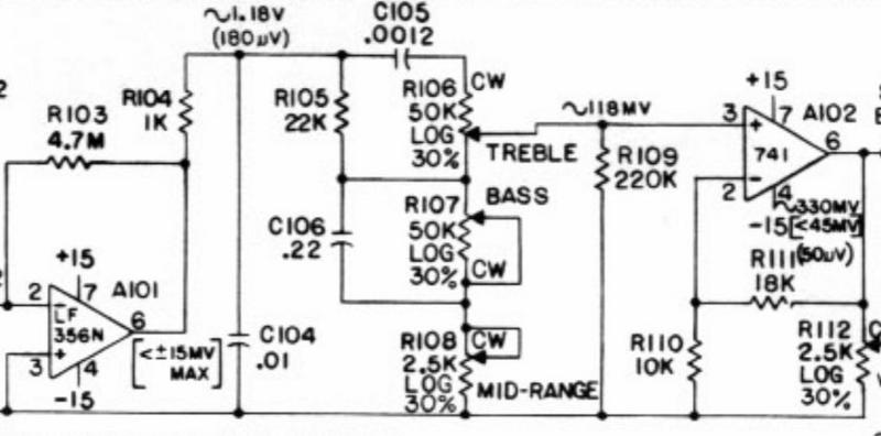

Check this one: https://elektrotanya.com/PREVIEWS/63463243/23432455/fender/fender_frontman_212r_sch.pdf_1.png
it's a fender solidstate amp, it has higher pot values, but just in front of the next stage there is a 22k and 100k voltage divider dumping part of the signal to ground.
