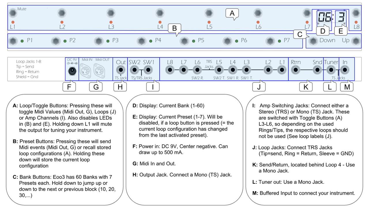

I already created an overview of the functions for the user guide:
Marshall Arts
