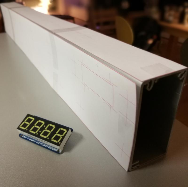

I knew it was going to be a PITA to make that square hole, but actually, it's not that bad...
In that stuff I think it's easier to make a square hole than a round one :-)
Definitely doesn't like drill bits.

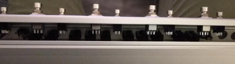

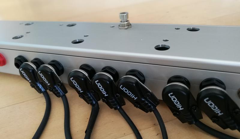

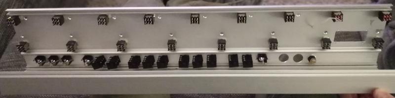

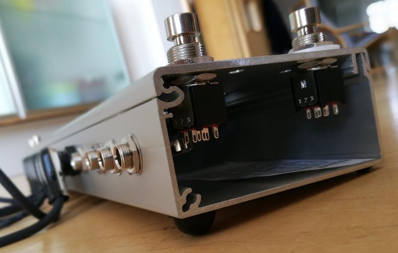

First Jacks arrived... looking good so far, also with the placement of the PCBs. Bummer: The mounting holes in the PCB are too big (radius <> diameter   :o)
I will use rubber feet on the rear side (and tiny ones on the front): Easier access to rear footswitch row (loop row) and ideal for using pancake jacks. Probably will use a bit higher feet ...

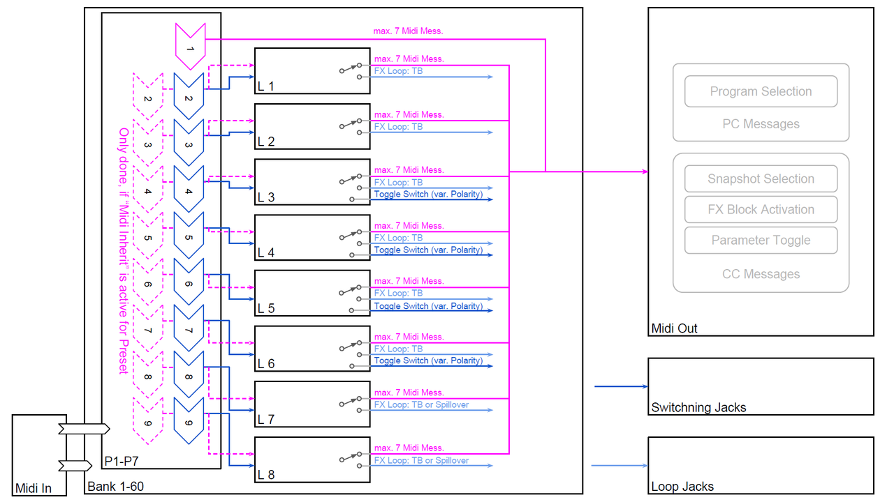

Working on the documentation. Hope that this image explains better, what happens
- on incoming Midi events
- when a Preset Button is pressed
- when a Loop button is pressed

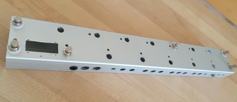

Labeled and everything...
Man. I am really sorry... Where did yet the enclosure from? I heard that it was a hard catch outside from Germany...
I'll go thru my paperwork.  It was a lot of detective work and it was sold as wire channel for high end modular furniture.  Cost me a fortune but is very cool.  I suspect if a bunch of us bought it the price might be more reasonable.
