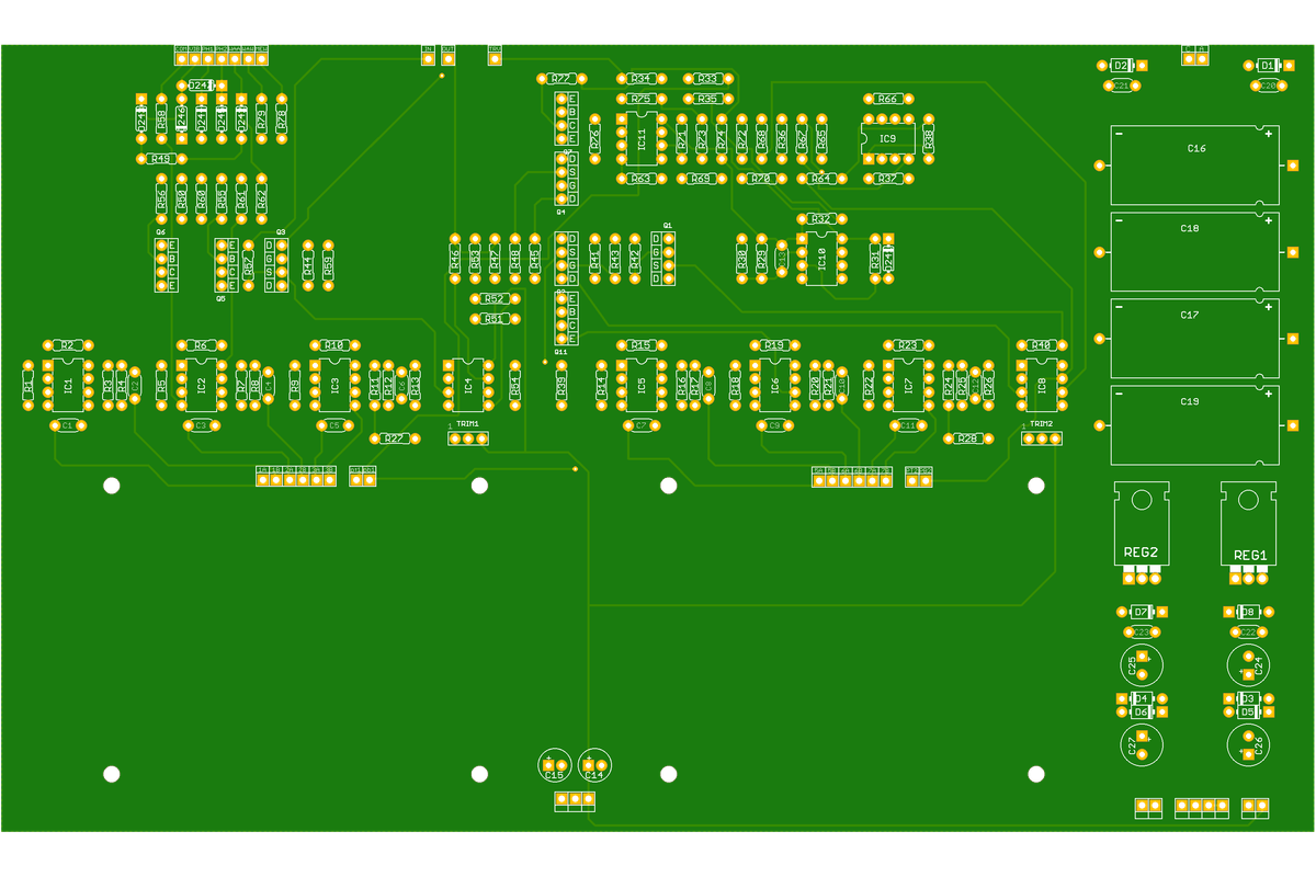

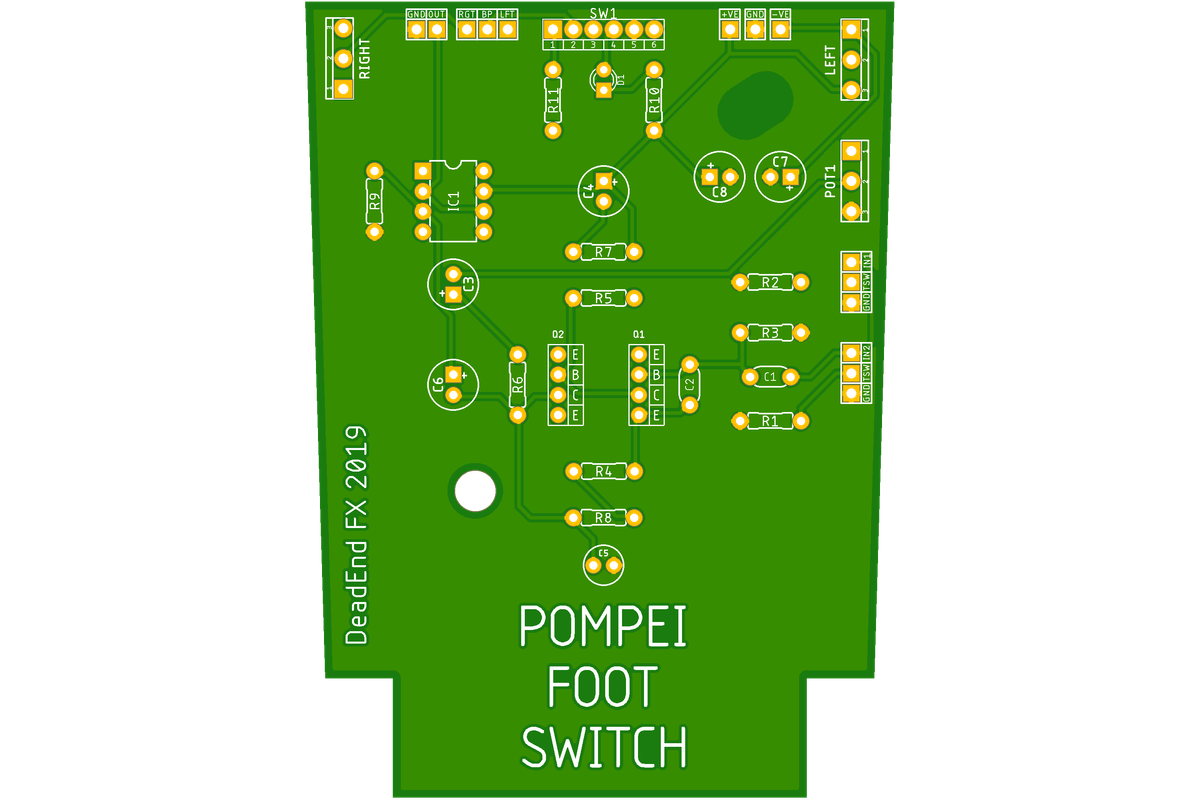

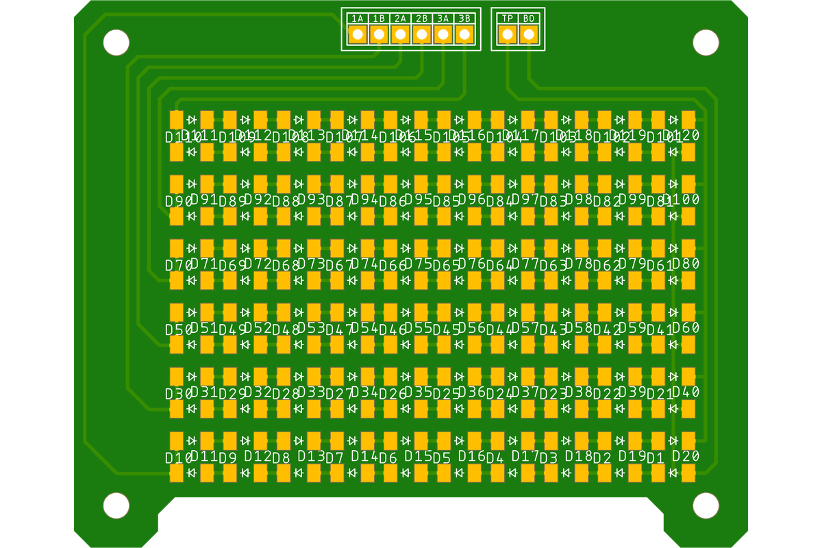

Here's a progess update
The top board which is the psu and phaser
One of the two identical diode ladders
And the pedal preamp

skyled
Please tell me that the diode ladder won't use smd diodes. It sure looks like smd in that picture.
PMowdes2
Quote from: skyled on March 09, 2019, 08:54:05 AM
Afraid so, only way to keep the size down to something less than a football pitch.  We are thinking of getting these fabricated assembled, it will add some additional cost but a whole lot less headache
