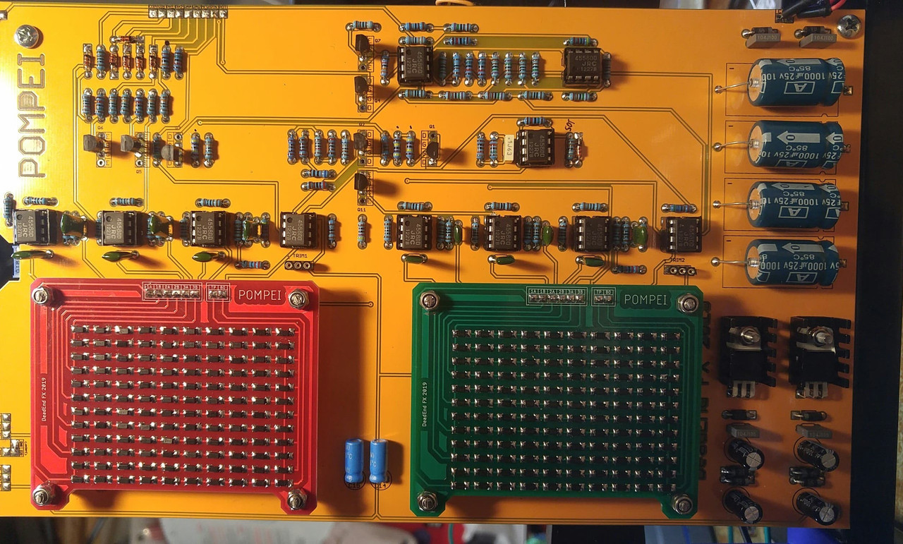

The original HiFli enclosure is quite large. You want to keep the pcbs as small as possible.
However many may not have the tools for SMD soldering nor a reflow oven (I don't have one, too). But that doesn't mean, that they will not be able to build it with Your boards in the end: the diode ladder is the most easiest part to build. 2 sections with 12 ladders with 10 diodes each are needed. On my vero layout this section comes to 13 rows x 36 holes per section only. So for example a vero-board as a workaround for BOTH sections would be approximately 9 x 10 cm (3.6 x 3.9 inches) in minimum size.
So workaround boards that will fit to Your board exactly are possible.
Keeping the phaser diodes on a seperate pcb is a good compromise therefore.

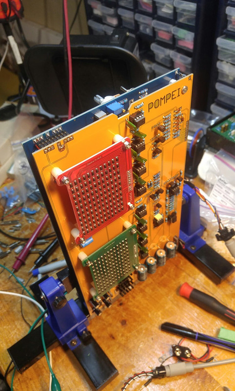

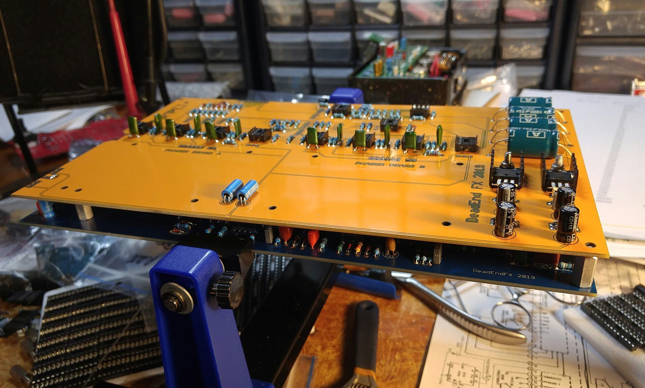

Think we are nearly done Greg.  I soldered the diode boards by hand and posted them to Canada, just waiting for them to arrive.  Dino's got everything else built and the fuzz section and the LFO seem to check out.  We might have a small issue with the bypass switching which seems to be different between the original schematics and the unit we traced but i'm sure Dino can figure that out.  It's been a bitch but the end is in sight.

Done and verified
Quick demo video on our Instagram page  www.instagram.com/deadendfx
