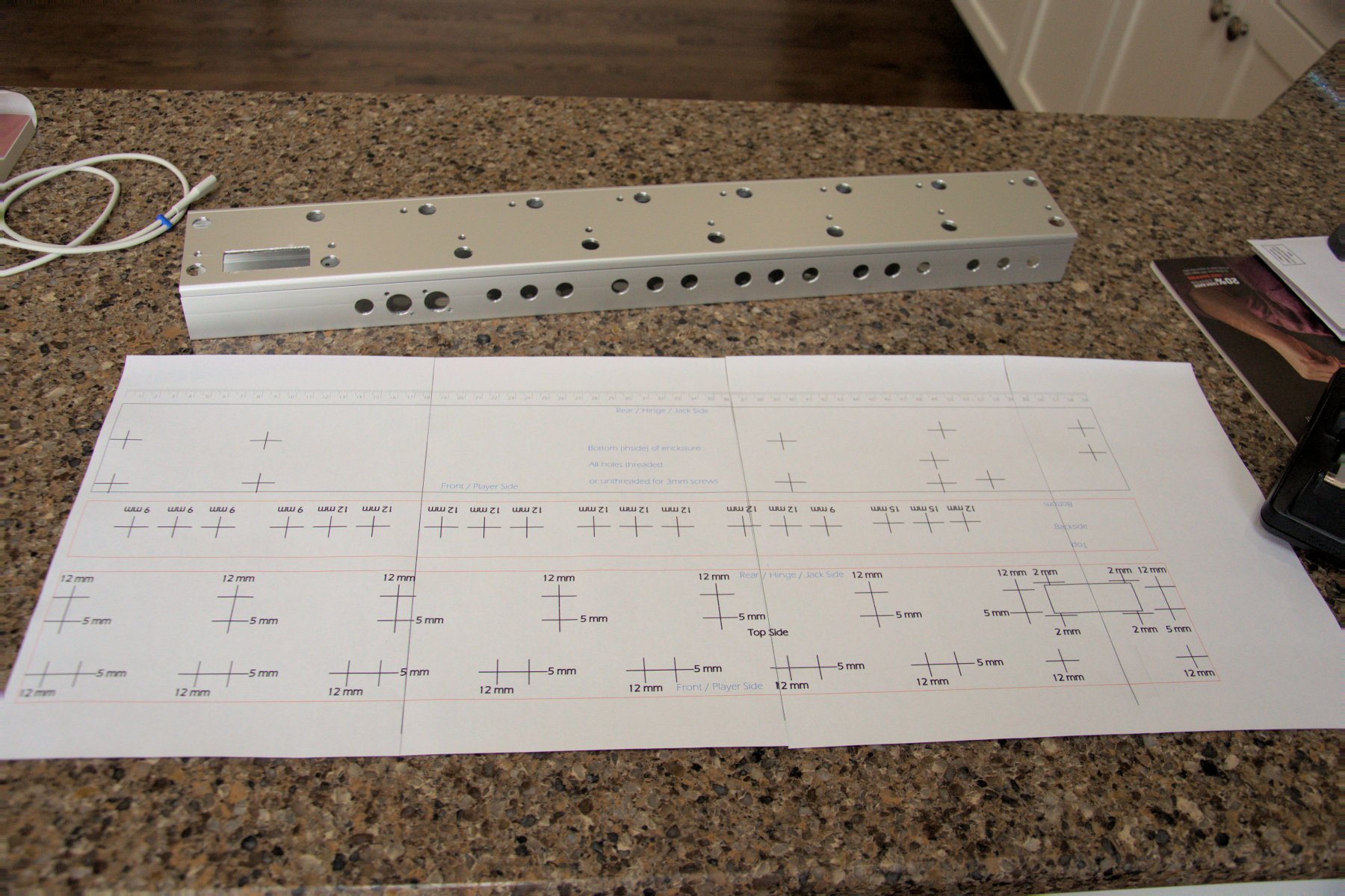

I've ordered parts from Mouser and will finish up with a few bits from BLMS, so while waiting I thought I'd get the chassis drilled out.  Marshall Arts has gone to a lot of trouble of laying out a very detailed drill guide in SVG format.  I downloaded and installed Inkscape to manipulate it a bit.  The zip file I'm attaching to this post is the resulting PDF files.  If you print them to actual size, cut along the lines, and then tape them together they will be exactly 59cm in width and layout all the top/back/inside-bottom holes you need, along with hole sizes.
The pages taped together and the drilled enclosure:
And more detail:
What are you using for an enclosure?
That looks super tidy drilling and cutting the square, top notch! Yes, wow, you're building this, epic.

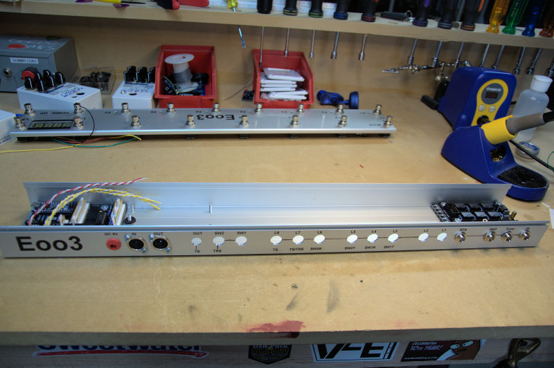

Here's a few progress shots and I'm hoping to get some of the wiring done over the next few days:
Note the bench stickers and the beer opener.  Oh and it's stain on the bench...not blood...really...

The display is my not so subtle attempt to rescue some jacked up drill holes.  I ended up using hot glue to mount the LED panel and used a chunk of hardware store lexan cut to size.  I taped it off and shot a border in black with spray paint.  I might touch it up with a bit of black paint inside the display cavity.  I'm worried about it breaking loose but I'll see how it holds up.
They are water slides and although the photo hides it a bit you can see witness lines around them.  I shot clear nitro lacquer to seal them.  It was about the only thing to stick to the coating on the aluminum.  If I do this again (I have another set of boards) I'd cut a piece of thin lexan the size of the front and it would serve as the display cover and protect the lettering.

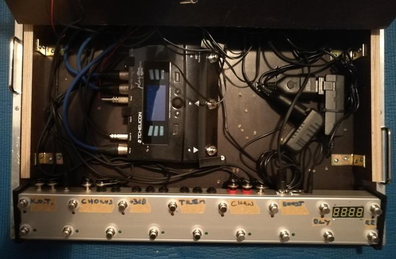

The biggest fun is putting it all together on a new board. Midi, stompboxes, amp channels... It's flawless. At first, it is some work to wrap your head around the concepts, especially if you are new to the midi side of things. Eventually, you end up with a few banks with master setups and you build your presets without ever bending down.
BTW, Gordo - here is an overview about how I use my Eoo3... I did that for myself, should I ever have to debug that thing...
