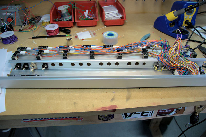

Well, "wiring in a few days" ended up being half the bloody summer but I'm back at the bench.  I'd forgotten how much work a new puppy is.
The code is in and the footswitches are wired up and all appears to be working very well.  I haven't tested midi functionality yet but I have little doubt it's good.  The wiring looks like a rats nest now, although it was all neatly bundled.  I'll get to that in a minute.  It's going to be challenging to jam all those wires in and get the lid closed so will just take a bit more planning and dressing.

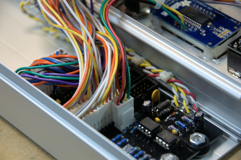

My wiring issue was the angled connectors mounted to the footswitch boards.  On Marshall Arts' build his connectors had the release clips on the top, which makes it MUCH easier to unplug the connector if needed.  And in my case it was needed.  Hardly a big deal but my release clips (connectors purchased from Mouser) are on the bottom.  Even though I'd read the build docs multiple times...in my brain I rotated the wiring scheme to be upside down to compensate.  Obviously I didn't put a lot of logic to it.  Here's how my connectors (wired correctly now) look:
So all my wiring was backwards.  Turns out not to be that big a deal: with these connectors it's just a matter of inserting a flat blade screw driver into the slot that the crimp connectors plug into and they pop right out.  I had every footswitch rewired in under 15 minutes.  I had to cut apart all my neat wiring bundles but it turns out I needed to anyway.  Space under the display and on top of the controller board is a bit tight.
I should be able to reroute a bunch of this stuff around the midi connectors and over the loop 7/8 tails board (not installed yet)  Wire used here is the Smallbear 24ga and would be nice to have something with less jacket.  I really like the wire though.  I picked up some of their fine gauge RG-174 for the shielded runs to the jacks so that will help.

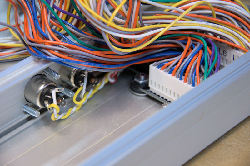

Testing this beast tonite.  I got the tails board in only to find out that there was no possible way I was going to close up this beast.  I've made every mistake imaginable on this build so I should have figured as much.
The nice part about having crimp connectors on everything that if it was all soldered it would have taken me forever to redo the wiring.  I had to bite the bullet and cut a considerable amount of length off of the loop button wring.  Honestly, within an hour or so I had 32 wires shortened, recrimped, and inserted back into the connectors.
