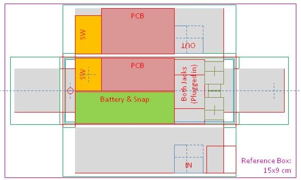

Hey, guys. I don't know about you but I've bungled a few of these unforgiving little @#$%$ when trying to get the most usable space inside. I recently sacrificed a 1590A so that I could learn what works and what doesn't.
This isn't the end all be all for measurements on this enclosure. I'm sure there are better setups, I've only been at this a short while. But I thought this might help someone that's about to start their first 1590A as an idea of at least where to drill without trial and error.
Make sure you use the external power jacks, ever extra bit of space inside the enclosure counts.
https://www.taydaelectronics.com/dc-power-jack-2-1mm-enclosed-frame-with-switch-external.html
Use open mono jacks so that you can get them close together, also make sure you bend the lugs so they're parallel with the sides of the enclosure or they'll be in the way of the guitar/amp cable tips and the footswitch.
https://www.taydaelectronics.com/6-35mm-1-4-mono-chassis-socket-jack.html
One thing to watch for is the little metal tab that's part of the Tip connection. Sometimes it sticks out higher than the wafer sections on the jack and could end up touching the enclosure and grounding out. If your jack looks like that, you can do this to slide it down out of the way.
Both of these jacks are good to go.
Here it is all put together.
Anyway, I hope that helps at least 1 person from ruining an enclosure due to a measurement error. Again this is not the end all be all, it's just what I've found to work well. If someone has a better setup, please show me because shoehorning stuff into these enclosures is fun/frustrating and if I can get a few extra MM out of it, that'd be awesome.
Cheers!
MTK

Thank you. I built using 1590A box just sometime in the last months, and every time I have to measure it like you with very very care.
I converted the inch in mm.
Footswitch: 11,1mm from the base
Power Jack: 11,1mm from the top
Input jack: 14,3mm from the top; 15,1mm from the top
Output jack: 14,3mm from the top; 23,8mm from the top
«Just because I cannot see it doesn't mean I can't believe it»

Hey, dude. The lugs are about 1/8" from the enclosure so, they're fine. You can throw a little tape on there if it gives you peace of mind. I don't understand what you mean about the tips creeping together, the jacks don't move.

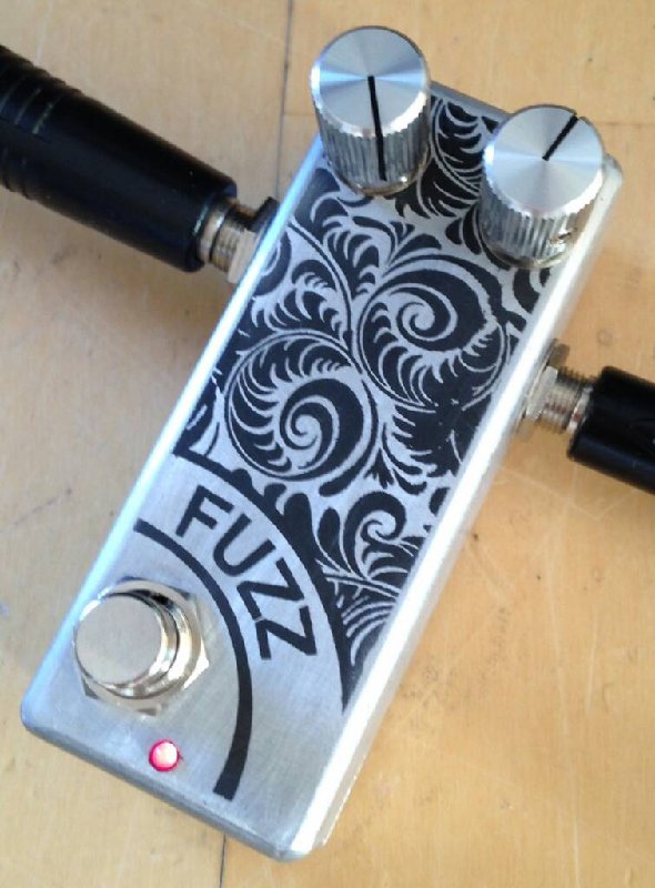

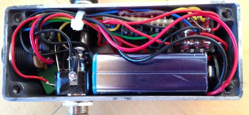

I once built an Axis Fuzz Face in a 1590A, where the jacks align on one axis (pun intended). Oh yeah, and I put a battery in it as well, as I wanted to avoid echoes in the enclosure  ;-)

Quote from: Marshall Arts on February 25, 2020, 12:08:00 PM
Now you're just showing off.  ;)
What are those little jacks you've got there? Having them not staggered would save a bunch of space.
I am sorry, I could not resist. I am not sure, if I would do that to me again, but staggering the jacks gives you a lot of space, if you don't use a battery. Oh yeah, and you would not have to use a TRS jack for the input to disconnect the battery either. The Jacks are regular Lumberg Jacks like this one here: https://www.ebay.com/itm/Lumberg-6-3mm-chassis-mono-jack-chassis-socket-/291403000107
With a bit of bending the solder flaps (?) , it is absolutely doable. Just keep in mind, that you need some extra space for the tip connector to move when the jack is inserted...
