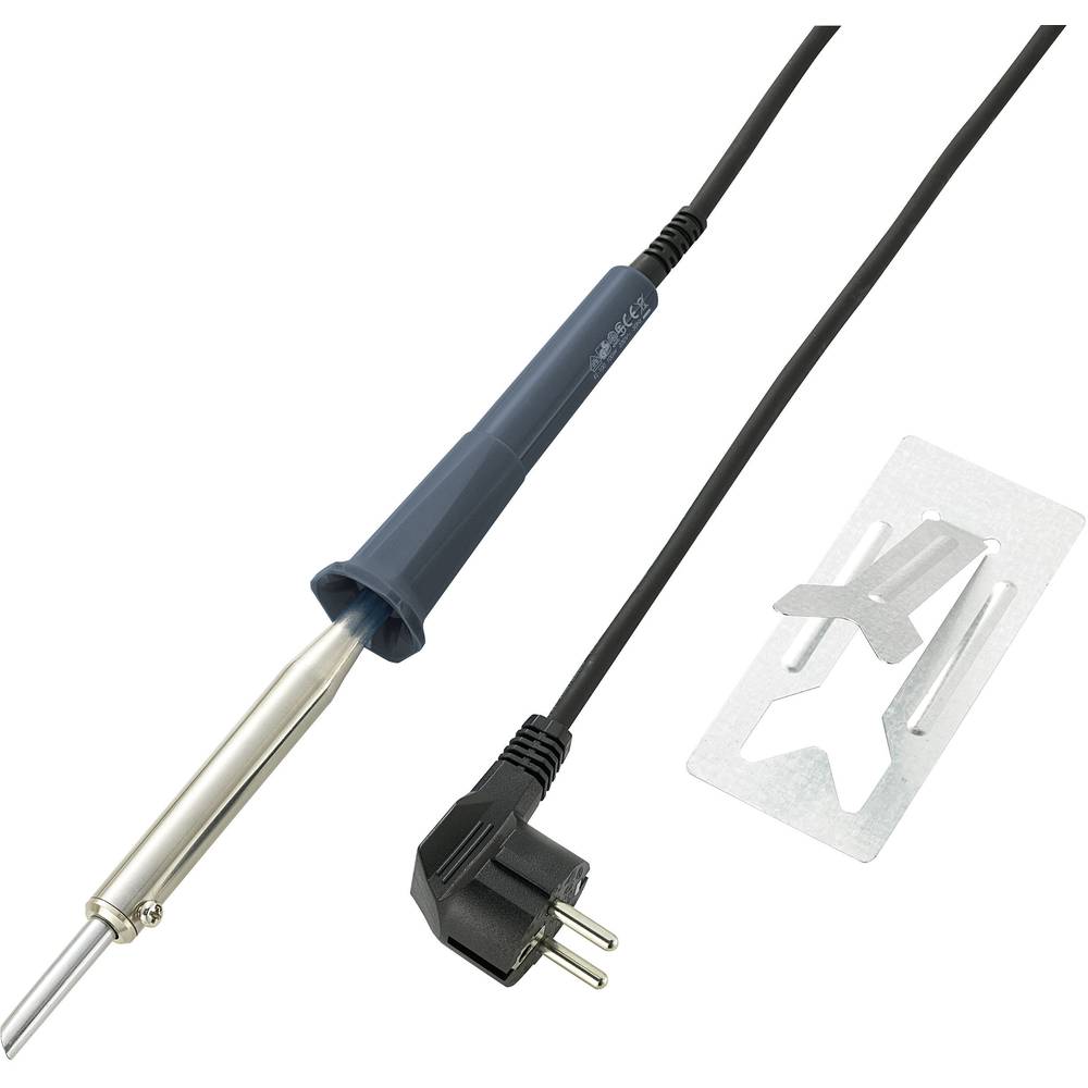

At work, in an old drawer, I found something like this:
Not exactly the same, the tip is almost identical, but it's attached to a simple shaft that I can attached to this:
Which is a bit oversized, but works great to remove IC sockets, relays and everything with more than two pins. Not for stomp switches, however.
Unfortunately it's very oxidized and not that effective anymore, and I can't find a cheap replacement  :'( :'( :'(
