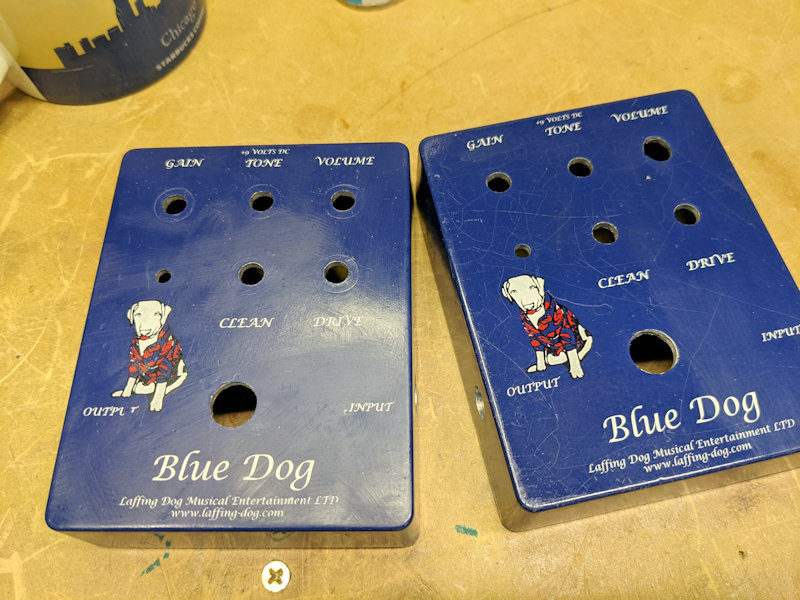

The pedal is old B-stock from when I was still building Laffing Dog Blue Dog overdrives.  The enclosure on the left is the worst with tape residue and some nasty scratches.
I sanded it smooth after using Naptha to remove the tape.  We had them powdercoated and then 3 color screen printed followed by a clear coat of lacquer.  Most of the damage is in the clearcoat.

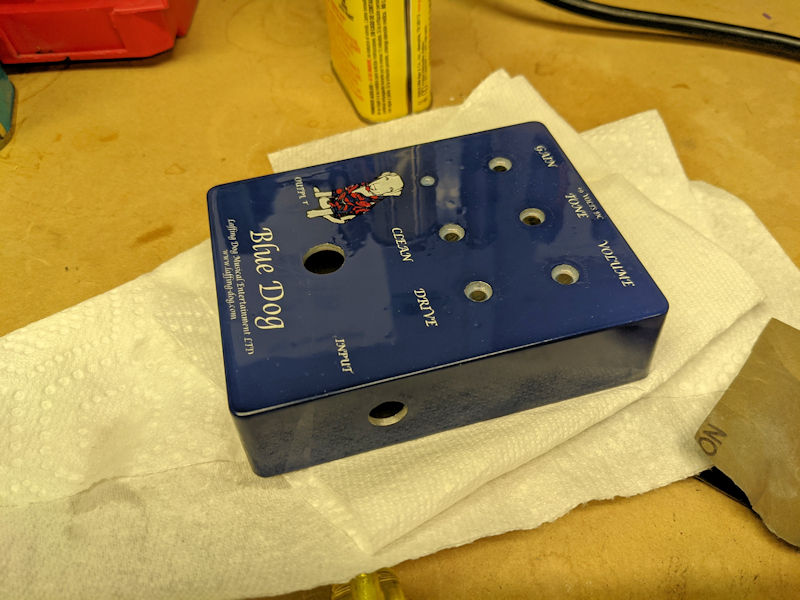

I dipped this box and then let the runoff drip before setting on paper towel.  This is the first coat and is dry.

That looks great, Gordy.  I usually go 24 hours between coats (maker says 8 hours) and another 24 hours before installing pots, etc.  If I screw up and need to retouch, I just blanket the whole surface and it blends with previous coats well.  Touch-up with a small brush doesn't blend as well.   Mike

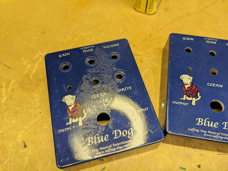

I think I need to let it dry longer as you mentioned.  A recoat looks much more dull.  I'll let this one sit and hit it again tomorrow.

It also likes a really thin coat, I usually hold mine with the face vertical and let it drip dry for 5-10 seconds before laying it flat to dry.  A cold or humid environment (my garage right now in TX) will cloud it before it cures, so I work in the house in winter.  Smells nice, too.   ;D
