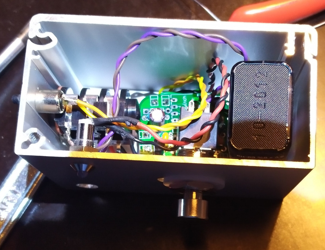

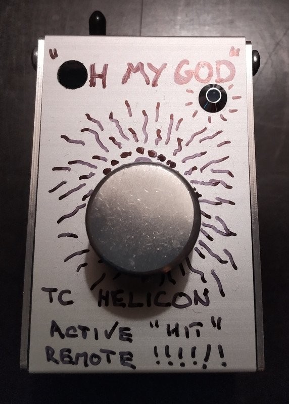

I was in urgent need to remotely activate/deactivate my TC Helicon Play Acoustic live. TC Helicon only provides switches without LEDs, so I build one WITH LED based on a smart switch PCB I designed like 3 yrs ago. The switch shows the urgency I was in ;-)
Now comes the nerdy stuff:
This pedal (like many others) needs a momentary switch to be activated and deactivated. My switch uses a DPDT momentary switch to directly communicate with the pedal (first half) and to interface with an Attiny85 to alternate the LED-Status. I could have used an NE555-based circuit as well, but the board was designed for an Attiny.
Here are some questions:
  • Is there really no commercial pedal that works momentary on the jack and latching on the LED? Hard to believe, but I did not find one.
  • The Helicon needs a TRS-cable. My Switch makes a connection between Ring and Tip, however, I want to use standard cables with TRS on both ends. I use a 9V battery for the Attiny and the LED and would like it to be disconnected  when I pull the TRS plug from the pedal. I only found the very pricey Switchcraft 13 Jack (which is mono, but that's ok) that comes with an "isolated make circuit" switching function. Are there any other Jacks available?
