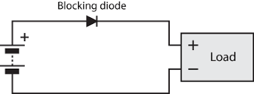

Scruffie
100R is probably enough, just stick it in between where 9V comes in from your jack to the board, or actually, even better, you can use a 1N400X (1,2 whatever) diode in series with the supply for a 0.6v drop and also the added benefit of polarity protection (don't know if that's already on board).

Is your "protection diode" a 9.1V Zener or a 1N4001? I can't find the V1 PDF, but if it's a Zener like in the current version and you were seeing more than 9.1V, something was wrong with your diode.
Scruffie's suggestion is for ACTUAL polarity protection with a power supply. The 4001 to ground only works with a battery, and only for a short time. It will blow almost instantaneously with reversed polarity from a power supply. You can use a 1N5817 in series for a lower voltage drop (.2v instead). But the 100R current limiting resistor is much more important.
