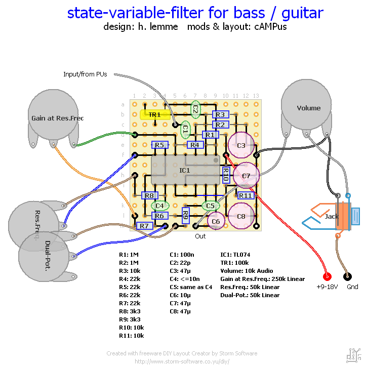

Bingo! I tried this perfboard but failed. That was my last attempt at perfboard...
But there is also a PCB layout and even Eagle files and that worked great:
http://forum.musikding.de/vb/showthread.php?27375-Alembic-SVF
(Eagle files also here: http://forum.musikding.de/cpg/albums/userpics/17486/alembic-state-variable-filter.zip)
Here's the schematic:
BTW Lemme published this SVF in his green book back in 1978.
Has anyone been successful building this circuit???I really want to try it...
Yes, fired up on first try. Used C taper for the freq pot but B should be fine too.
Edit: Just to make clear: the perfboard layout here certainly does works too, it's just my poor skills at working with perfboard that caused it to fail.

What does the dual pot actually do???Does it balance from one freq to the other?
RobA
  • Posts: 1871
    • Music Unfolding
Re: Pickup simulators
« Reply #12 on: September 20, 2013, 09:09:42 AM »
The structure of the SVF needs those two resistors to move together. It can work to fix one and move the other, but this comes at a cost of frequency range and screwing up the shape of the filter.
I'm a bit confused as to why an SVF though. The main strength of the SVF is that it's got LP, BP, and HP taps in the one structure. If you aren't using those and only want the LP, there are probably better resonant lowpass filters that you could use.
Another alternative would be using a combo of a high shelf cut and a PEQ filter for the resonant peak. You could set those to move independently and get a wider range of pickup simulation and tighter control of the Q and resonant peak height. That'd be a few too many controls on the instrument, but if you are going to do it in a box, it seems like a good way to go.
« Last Edit: September 20, 2013, 09:19:12 AM by RobA »
