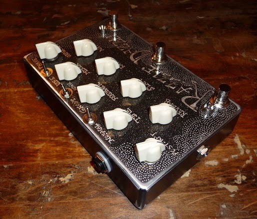

From my spring contest entry:
"Razzle Dazzle"
It is a Zero Point DD/Galacticon Phase Shifter/Rub-A-Dub Reverb 3-in-1
I am timbo_93631
clearanced center screw boss:
I have built a few pedals with the Galacticon on the repeats of a ZPDD or pre/post that have been in the regular build reports, this is an expanded version that includes a Rub-A-Dub.  The rotary switch on the right assigns the Galacticon to the repeats or pre/post delay with an additional toggle and it is footswitchable.  The rotary on the left assigns the rub-a-dub to the repeats or post delay and it is always on.  The ZPDD has been modded for trails bypass following midwayfair's shunt bypass method, and the Galacticon has a phase/vibe mod and a 50k blend pot labeled "nature" on the controls.
The ZPDD also has the feedback and slam controls on a momentary 3PDT so you can dial in the speed that it slips into self oscillation.  Clip to follow.
SWITCHING MADNESS!

Great looking build! I love the finish on the box, dremel etching? Very neat wiring too! I just finished a two in one with that same wire but mine looks like the spaghetti factory blew the f' up ;D

Quote from: timbo_93631 on April 21, 2014, 11:12:13 PM
Dude. This build would be impressive enough if you just had the three circuits in there, but this switching is some next-level business.

Quote from: jrod on April 22, 2014, 01:11:46 AM
How do you keep up with the same color wiring? Amazing!
I just go one wire at a time and do all the switching wiring and jacks first, then the boards and pots, then LED's and power.
Quote from: sonarchotic on April 22, 2014, 02:02:15 AM
Silver water based Sharpie paint pen with the extra fine tip.
Quote from: pickdropper on April 22, 2014, 02:12:46 AM
Amazing wiring, really.  I can't imagine how long it took to do that.
Maybe 3 hours on wiring alone, about 10 hours total for the build.  I wanted to do the verb and phase on rotaries completely without any additional toggles, but that would require a 6P3T rotary to make all the bypass connections on the delay line and I didn't find one that would easily fit the depth of the 1590DD.  The ones I found might work in a 1790.  Anyhow, I lie awake in bed more than a few times trying to visualize the switching before I realized 4P3T's were only going to be good for repeats/standalone and not repeats, pre/post delay so they are set as 4PDT's for repeats/standalone and an additional 3PDT toggle for order when the phase rotary is in the standalone position.
