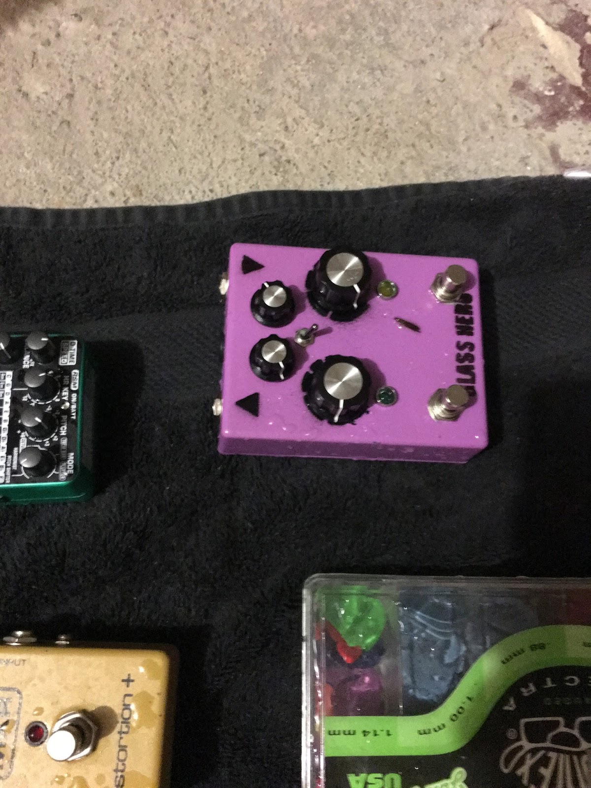

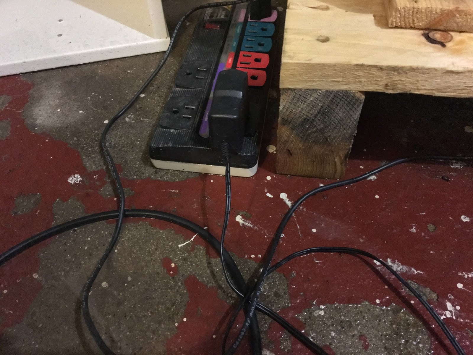

So I had every intention of entering a new build this year. It's actually 75% done too! It was going to be the SS/BS Team Awesome Fuzz Machine clone that Effectslayouts did a while back. It can be found here http://effectslayouts.blogspot.com/2016/10/smallsoundbigsound-team-awesome-fuzz.html if anyone is wondering. But, this will not be happening for me. Christmas Eve I went down into my workshop and found a disaster. See pictures below.
It might be hard to see but My amp, pedal ICs, and all the gear around it was covered in water for days. This means that there was time for it to get on the boards and guts of everything. Including my pedals and my Gibson Les Paul that I just put new mini humbuckers in. If anyone has advice on what to do here that would be cool. I'm going to check with my home owners insurance covers it. Aside from taking everything apart and making sure its dry what else should I do? Thanks guys.
I'm assuming everything was powered off when the water damage happened, because guitarists are totally environmentally conscious and would never allow their devices to suck power for days on end without being used.
Amp: unplug everything (speaker, tubes, 3-prong plug if it isn't attached to the amp), drain the filter caps safely (there are tutorials for this! DO NOT HURT YOURSELF), and remove the chassis from the cabinet. You can hand dry any moisture you find. Then let the amp sit in a dry place for let's call it 48 hours. Inspect it after that time. If it's moist at all, just give it more time. You should be able to remove the pcb from the chassis as well to make sure that air can flow under it and dry it out.
Pedals: Open up the backs and let them dry out. If you have a giant bag of rice, you can stick them in there, but it might not be necessary.
Cables: unscrew the ends and let the tips dry. These should be fine pretty quickly.
You primarily want to get them dry ASAP to prevent corrosion. There's less danger to the electronic parts being destroyed than you might think. The amp could be physically dangerous, though (to the amp and you), so again just make sure it's .
oh shi**, that looks bad indeed. I support Jon's suggestions. If you have some of the small silicate drying packages left from various purchases (you know the small bags that are often included in commercial products) you can also put those there.
I'd open all the pedals, dry them as good as possible and then let them sit in a dry, warm place for a few days before trying to apply power to them (maybe take ICs and transistors out of the sockets, so there's no water in there...). As long as they weren't powered when the water hit, they should be fine.
Cool thanks for the suggestions guys. The only thing that was on was the power strip that the amp an tuner pedal was plugged into. The amp was off but I'm not sure about the pedal. I already pulled the power supply apart and that looks like nothing blew up. I also cleaned and inspected the cables (those are the least of my concern) those looked good. I'm going to open the pedals up and let them dry out today. I have a dehumidifier running in the room right now. I might bring the heat gun from work home (or just buy a cheap one from HFT) and see if that helps.
In the meantime I'll look for a good tutorial for draining the caps on the amp and start in on that tonight too. Thanks again guys.
