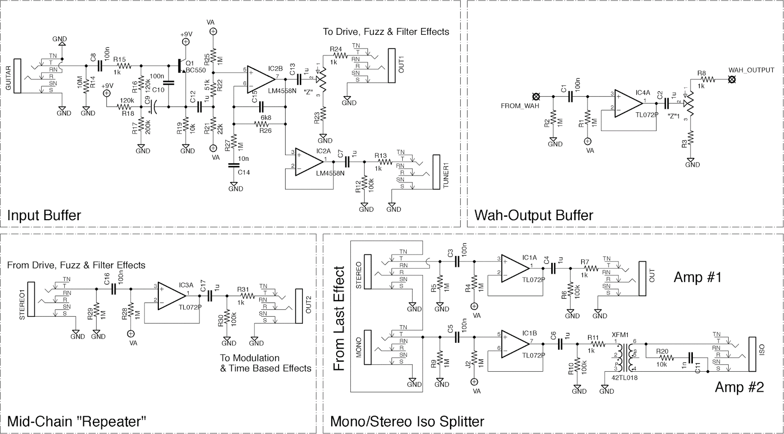

287m
maybe like this?
credits to azilts/coldcraft
