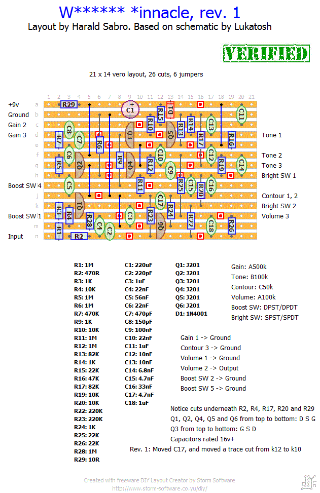

Sabrotone has a pretty good layout for this too.
http://www.sabrotone.com/?attachment_id=3123

So i have a Transistor tester that will do Jfets but not exactly sure if this can get me there. I will build the one from tag board, there is the improved and greatly improved. Here is a photo of what I got. Might be a little hard to see those are 6 different J201's that cme with the kit
