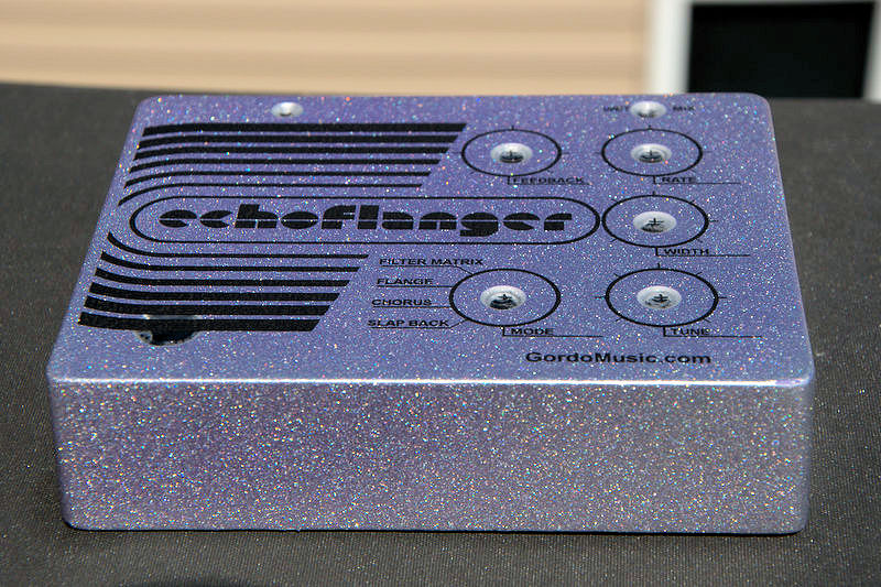

Here's a shot of the enclosure drying in the sun.  I love the finish on this...

Quote from: gordo on June 02, 2017, 12:04:53 AM
Purtyyy.

Oh yeah the color is really nice!!

The finish on this is superb, excellent stuff
czapa tranzystor 2
Holy crap,enclosure is killer

Awesome graphics!  I really want one of those enclosures.

this is really outstanding. Lovely finish and enclosure, too

That shot of the inside also looks like it's revealing some of the color.

What a beautiful build!
Is it a decal? Very clean and pro-looking!
