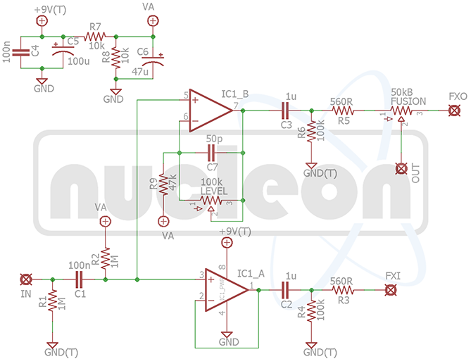

Rockhorst
This should help you out. Verified and tested, just insert your effect between FXI and FXO. It's a modification of the Schooner by Jubal/Grind that was previously mentioned.

Tuxedo3
Quote from: Rockhorst on August 26, 2017, 11:26:54 PM
This is awesome, thank you for this! Will that "level" pot help me with balancing the clean vs. effect volume difference?
