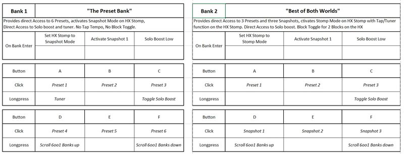

It's coming together nicely. Got a 2 line display working, waiting on a 4-line LCD-Display for more comfort. Midi is working as well. Here is a preview of two banks I programmed as a proof of concept:
Each of the six buttons can be clicked or pressed long and will trigger midi events (or a series of midi events). There will also be a (series of) midi events fired when a bank is changed.

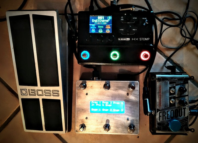

Here ist the new setup:
That's too cool.  Have you used it direct to front of house?  I'm already using in-ear monitors so it wouldn't be a drastic change to not "feel" the cabinet.
Quote from: gordo on October 19, 2021, 12:51:54 PM
No, I am still kinda oldschool in terms of "feel". I read that Steve Stevens is using wazacraft cab sims on stage now, so maybe it's time for me to think about in-ears and cab sims as well....

I wrapped this up for my live rig:
I will most likely stick with the configuration in bank one (3 Snapshots on the bottom row (buttons D-F), scroll HX presets up/down (buttons A/B) on the top row and a solo boost (Button C). This means, I will not change the code over in the near future, but document it well enough for everyone else to adjust it to their preferences. You can find it here:
