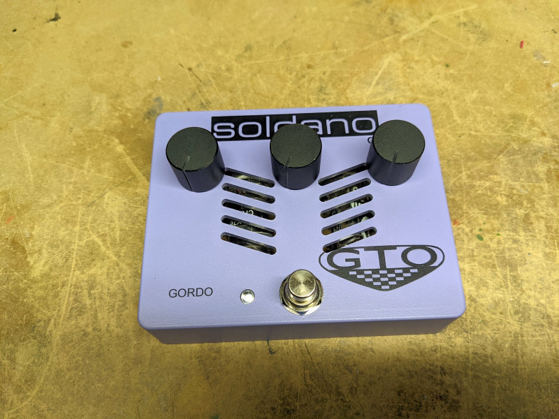

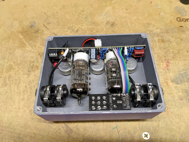

This is a cool one.  Nathan over at Sushi Box FX put out a pair of boards for a Soldano GTO type circuit and I'm pretty blown away by it.  He calls it the Black Eye.  I used shielded cable but I don't think it's really necessary.  It's 9v (and about 450mA) in and using electronic voodoo gets tweaked to 235-240v internally.  Similar concept to the old Grind Custom FX STM800.  This works exceptionally well and even with two tubes at high gains and volume this little beast is very quiet.
It's the sound of a cranked SLO and is a bit of a one trick pony but damn what a trick.

Thanks folks.  I got the enclosure from Nathan.  I think he may have a mill because the machining is just spotless.
Jimi the intent on this thing is to give you the front end of a Soldano SLO and while it doesn't have the tonal range or do the cleans like the real thing it is definitely in the ball park.  Even on my solid state bench amp it inspired a few Scorpions licks.  I was hoping to get it on my live rig this morning but I need to go thru the power ports on my Dunlop brick and make sure I can feed it.  The weird part of church gigs is 6:30 AM rehearsals and a LOT of coffee.
