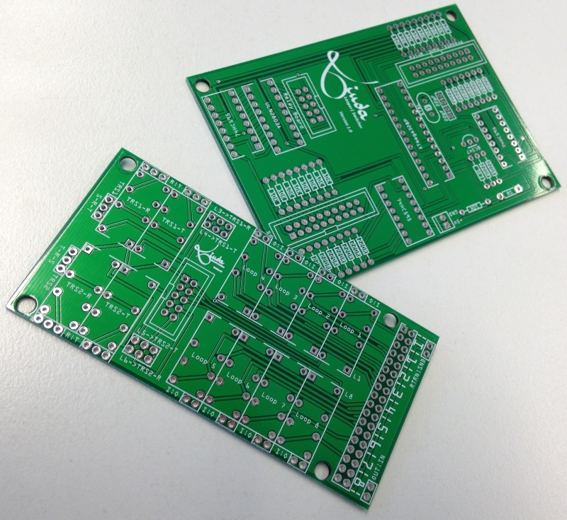

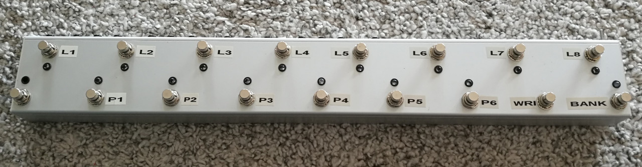

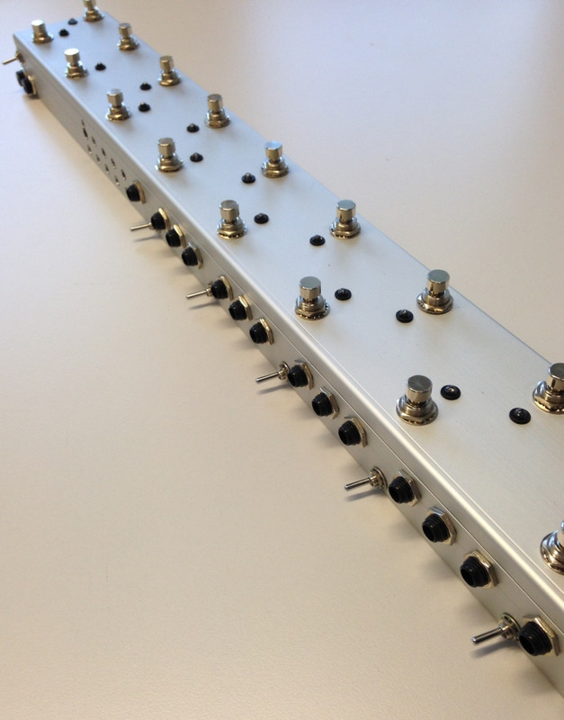

This is basically an arduino looper for eight loops with the ability to store 12 presets. It can also be used to switch up to 4 amp functions (required for my Engl Ironball). For another amp (Marshall 2554), I needed an additional switch to change the polarity of one of the switches (so the LED is lit, if the hot channel of that amp is activated).
Anyway, I built it already in 2015, resurrected it today from the basement and shockingly found out that I never labelled it, so I had to reverse engineer what the 6 mini switches, 17 footswitches and 14 jacks were for. So, the only reasons to post it now is twofold:

  • Remember to label in time, if you ever build something that big.
Eye-candy:
...and the way it looks today:

You should get the blocan enclosure, it's worth it. Check the build doc for details...
I would create a new version of the relay board, if I ever find time. I made it with fritzing (!), meanwhile I know how to work with eagle. Fix some minor issues, but God knows when I find time...

Your build is in 80cm long enclosure, right?

It's actually 60.5 mm long. I will see, if I find the time for a new release. Changes would be:
- Relay board:
-- Move Cable connections to the side of the board, that points toward the inside of the enclosure
-- Create an eagle component, that allows for easy shielded wire connection (basically a hole to push the cable through, with a solder pad for the shield and another solder pad next to that for the inner wire)
-- Correct missing ground connections (result of a bug in fritzing)
-- Improve ground plane (Version 1 has ground fill, but eagle can do this much better than fritzing)
- Control board:
-- Add space for blocking caps
-- change design to load a complete nano (like I have done on my moebius controller and my taprecise design) - they are dead cheap these days and come with an USB port, so people can program their own software, update easily etc. Plus, I dont have to program and ship them.
-- use internal pullup resistors in the Atmel processor (and get rid of the 17 10k resistors) - this requires inversion of the switch logic in the program code, though...
-- Add a Midi-Port. It's not hard to do in Arduino to send out static Midi program changes on events. And I might want to add a Line6 HX Stomp to my board somewhen in the near future...
